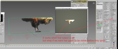

not sure if octane is not ready for phoenix 3 but we have a scene where one sphere is flying and spraying fuel and the other one is on fire catching that fuel on fire. But when we render we have fuel on fire (it has not been lit yet) and fire is not rendered at all Please help. Thank you

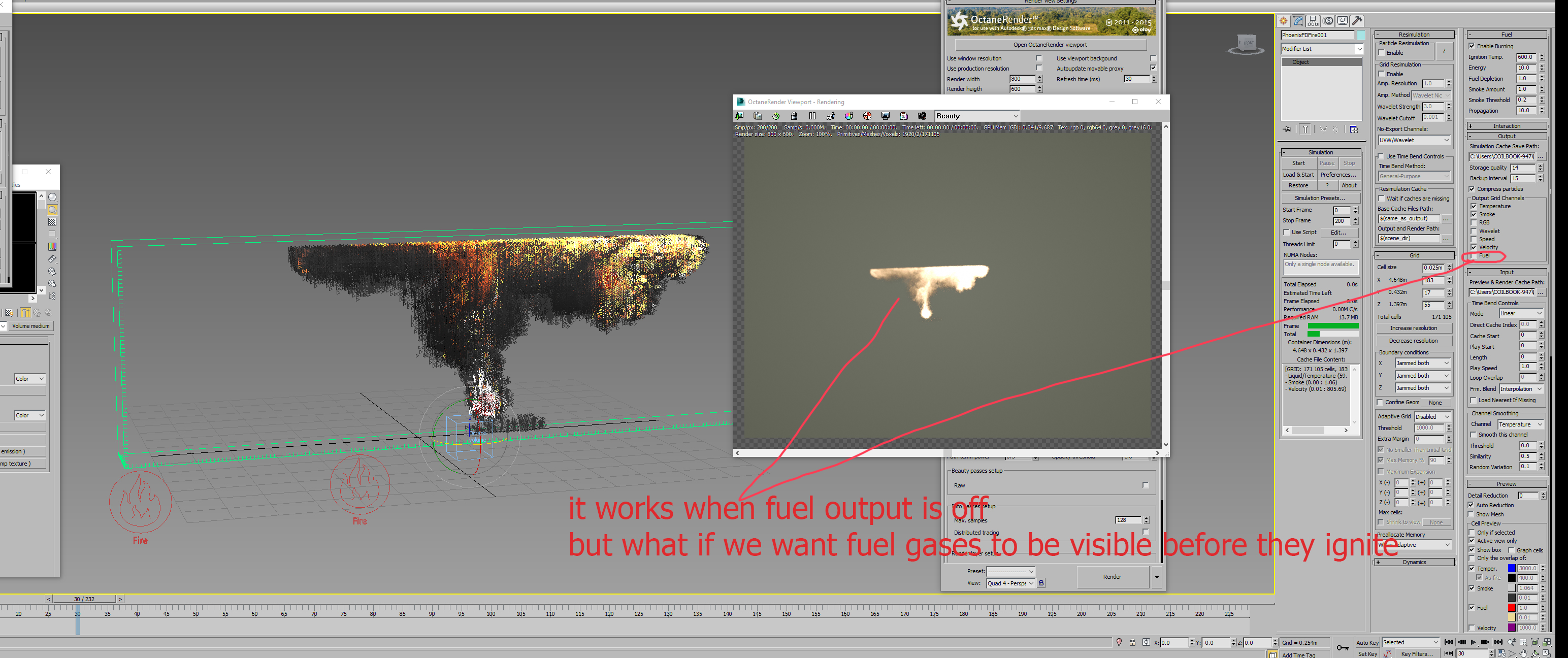

coilbook
Posts: 3178
seems like problem can be fixed when fuel output is off but what if we want fuel to be visible like a gas before it is lit

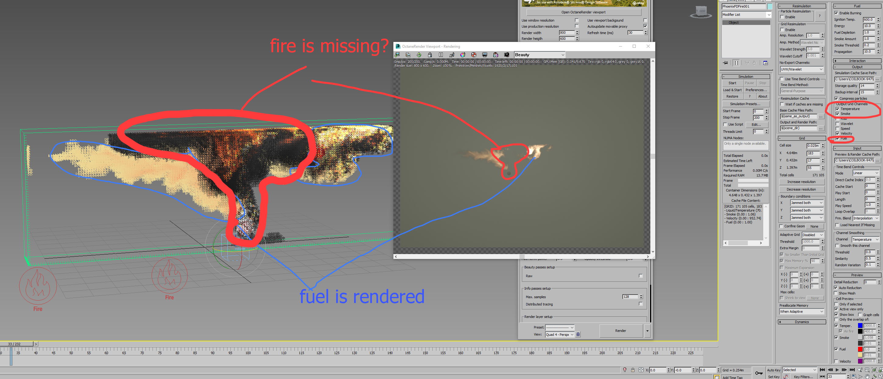

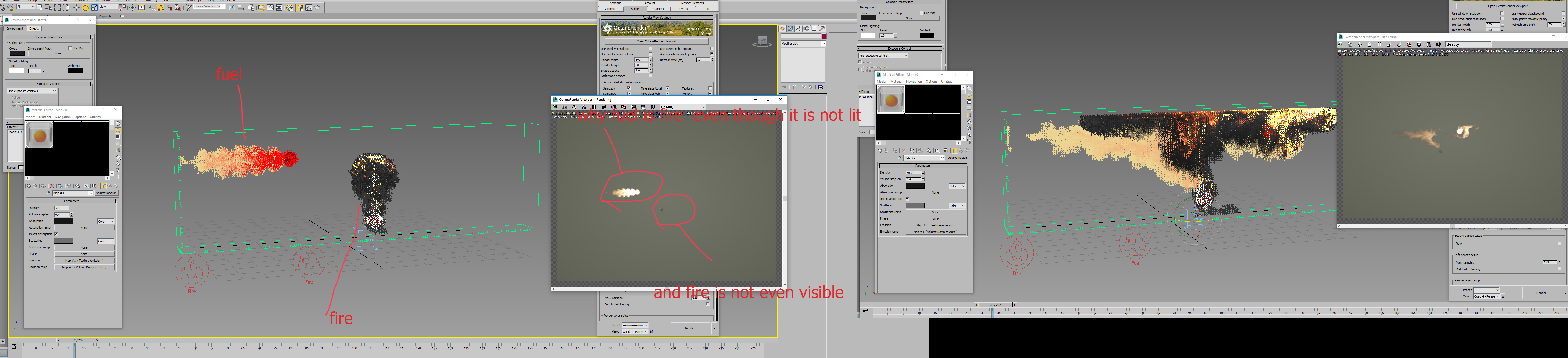

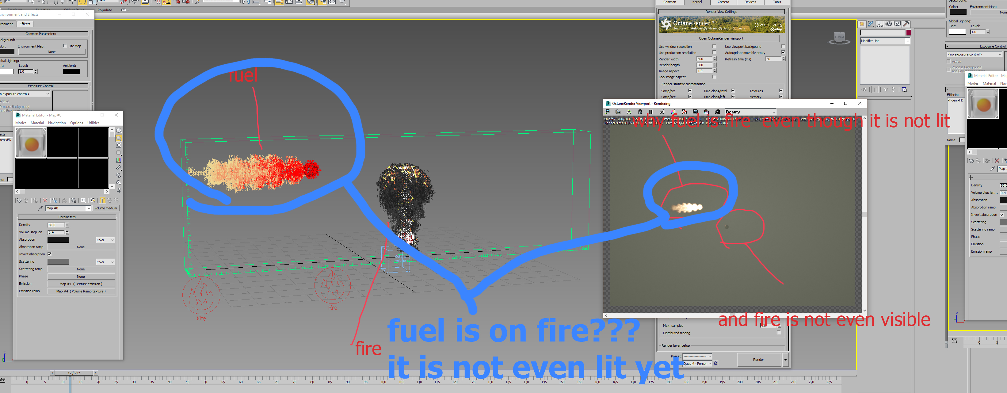

Thank you! However we have two main problems:
1. If fuel is enabled and we also have a separate fire source fuel is also on fire before it is even lit.
2. If fuel is renderable, fire is not rendered anymore. Empty space. Please see image attached you can see lit fuel but empty place where fire/smoke is supposed to be.
We want fuel to render as smoke/gas and not fire and fire to render as fire and not be missing.
