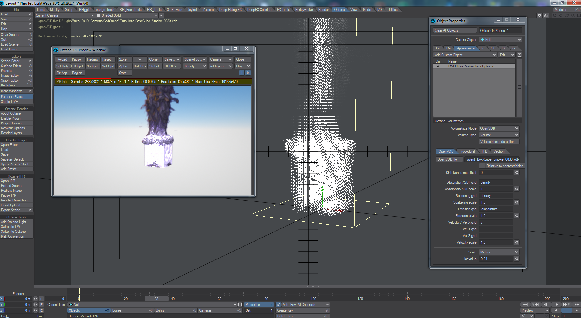

Again I had to deal with VDB sequence and Octane and again problems.
I made a sequence in LP based on the demoscene for LP2019. I saved the sequence and created a new scene. Added a Null object and assigned the Octane volumetric modifier to it. Additionally, I assigned a volumetric LV to the same object for visualization in the projection window of VDB files.

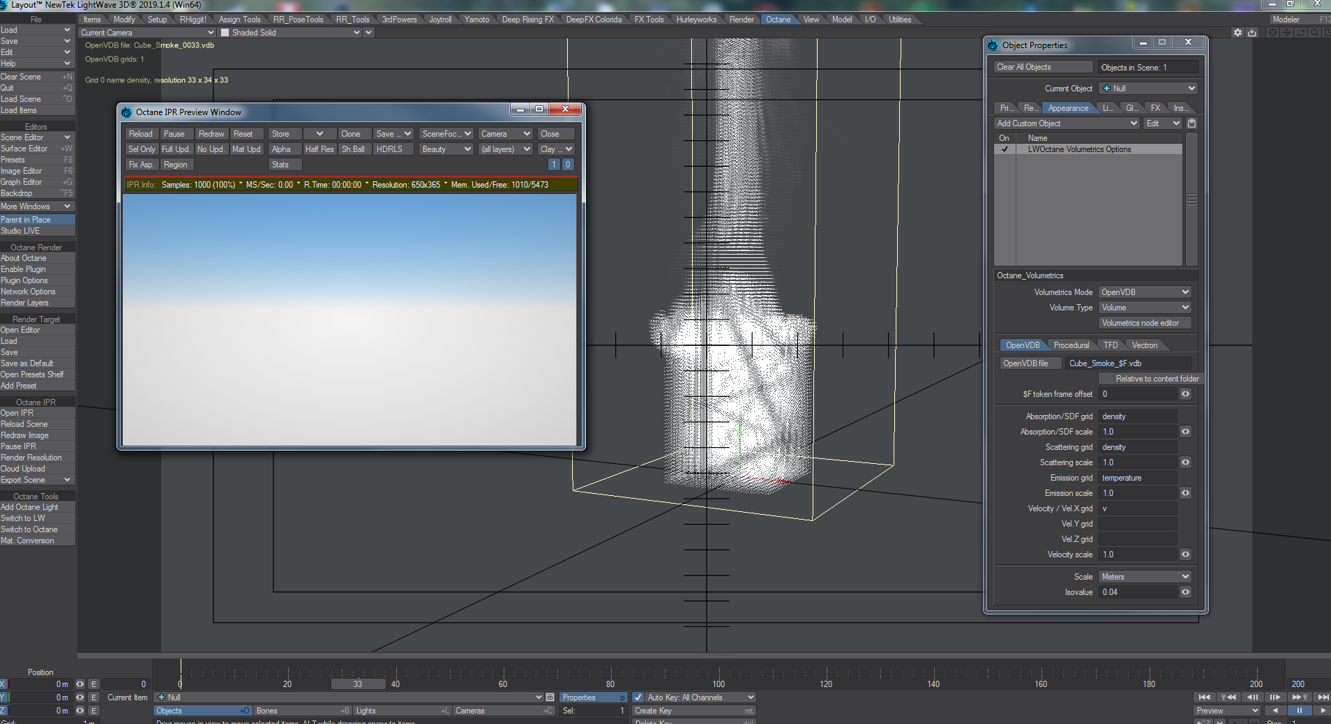

As a result, if I use only one frame for rendering to Octane, it is displayed without problems. But as soon as I load the VDB sequence, there is no volumetric in the rendering window.
The screenshots show this. What am I doing wrong this time? )

But do you have the right path for the file sequence? The path is not the same in the single frame screengrab. In the sequence, the filename is alone without any path.

juanjgon wrote:But do you have the right path for the file sequence? The path is not the same in the single frame screengrab. In the sequence, the filename is alone without any path.
Thanks,
-Juanjo
Thaaaank youuuuu! ) Finally I got it! )
