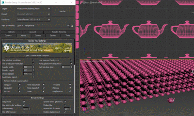

What wrong with render instances?
I have to wait 1 minut to see the image:
https://dl.dropboxusercontent.com/s/a2y ... 164711.gif
(fstorm and corona show it after 1 sec).
In standalone I dont have this problem also. Only in 3ds Max 2016 and 2014.
I also tried older versions from 4.10 to 4.23.
Update: Bug only with OctaneRender Viewport. When i hit F9 (standart render) it render without delay.

ramone163 wrote:What wrong with render instances?
same here OCtane viewport opens very very slow with lots of instances but also when it renders we have to wait 1 minute every frame just to load the scene every frame (viewtopic.php?f=24&t=57474)

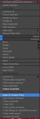

@ramone163
Hi ramone163,
The movable proxy command is not command corresponding to vray proxy, corona proxy or fstorm proxy.
If you wanted to use octane proxy, please refer to: Exports Octane proxy (screeshot)
The movable proxy allows you to edit objects etc, without refresh the octane view.
Activate indiscriminately all of movable proxy in the scene is no sense, except to slow down performance and render time.
About the speed difference between SA and Octane Render Octane 3dsmax plugin: 3dsmax eats RAM and Octane too.
Octane SA is essential and it does not weigh on the Ram as 3dsMax, so it is faster.
Regards
Paride
Hi ramone163,
Regards
Paride
