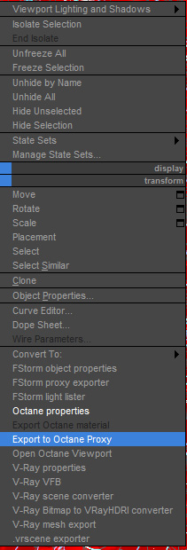

The movable proxy command is not command corresponding to vray proxy, corona proxy or fstorm proxy.
If you wanted to use octane proxy, please refer to: Exports Octane proxy (screeshot)
The movable proxy allows you to edit objects etc, without refresh the octane view.
Activate indiscriminately all of movable proxy in the scene is no sense, except to slow down performance and render time.
