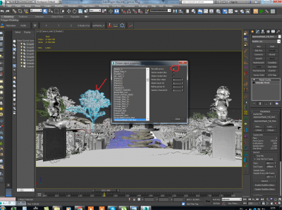

This 3ds max freezing problem is very odd. Yes some objects which have converted materials do that but sometimes with a clean scene I want to add texture environment or open material editor 3ds max hangs again. I tried vray, octane 2 . No problem. I cant understand this is very strange. I disabled auto converting, enabled it. Nothing changed. I can't do anything because of this randomly freezing issue. I tried v3.03.4 -4.21 - 4.22 . nothing changed.
I know I can't explain exactly what is my problem but I can't understand, too.

sequentia does not work
sequentia does not work, I have animated trees, on which they render static, in version 2.25 it worked
I ruined all the work, I have depended on the final scene of the works of the team and that's what I got in the end (( Give us an opportunity to render a dynamic viewport animations have been used in version 2
