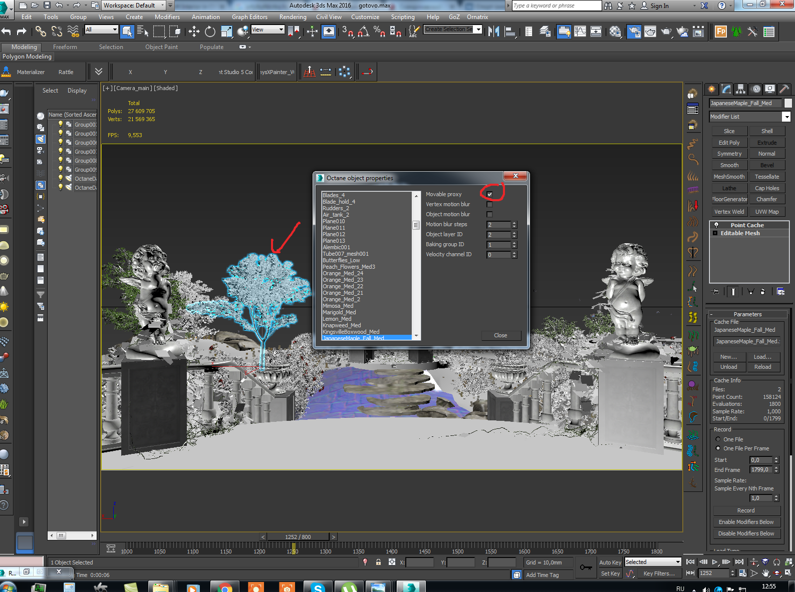

sequentia does not work
sequentia does not work, I have animated trees, on which they render static, in version 2.25 it worked
I ruined all the work, I have depended on the final scene of the works of the team and that's what I got in the end (( Give us an opportunity to render a dynamic viewport animations have been used in version 2

..again crashed while browsing through the channels in the render viewport - somewhere just after or on zdepth - different scene than I had the bug on last time
