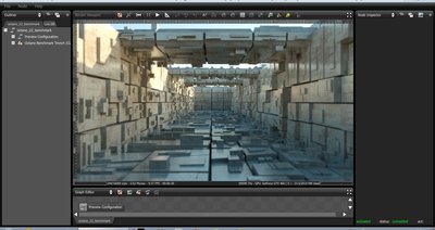

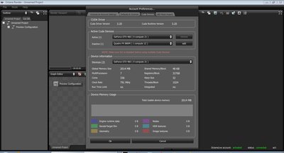

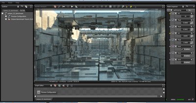

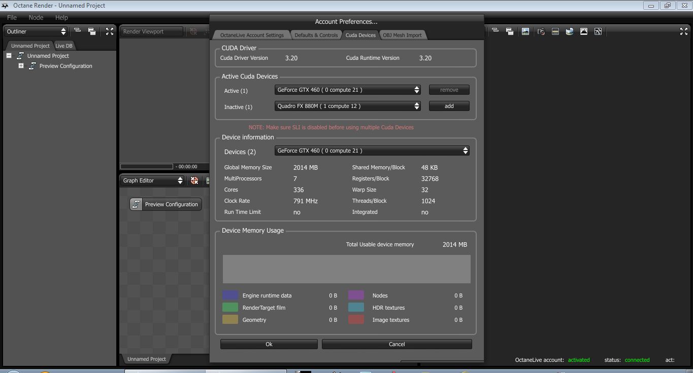

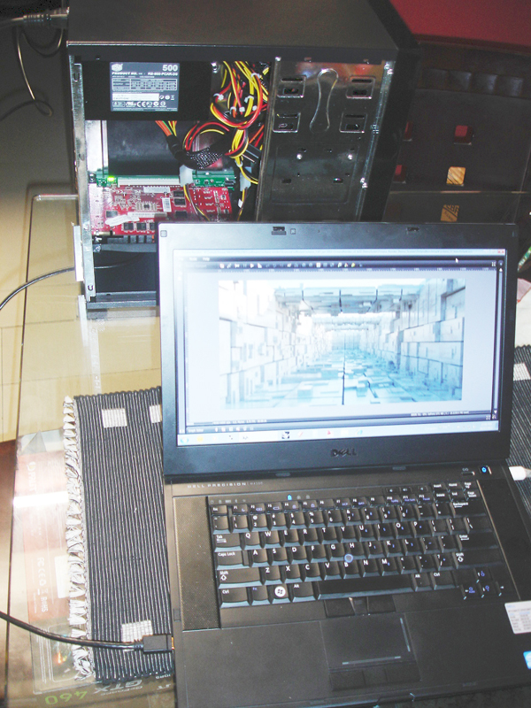

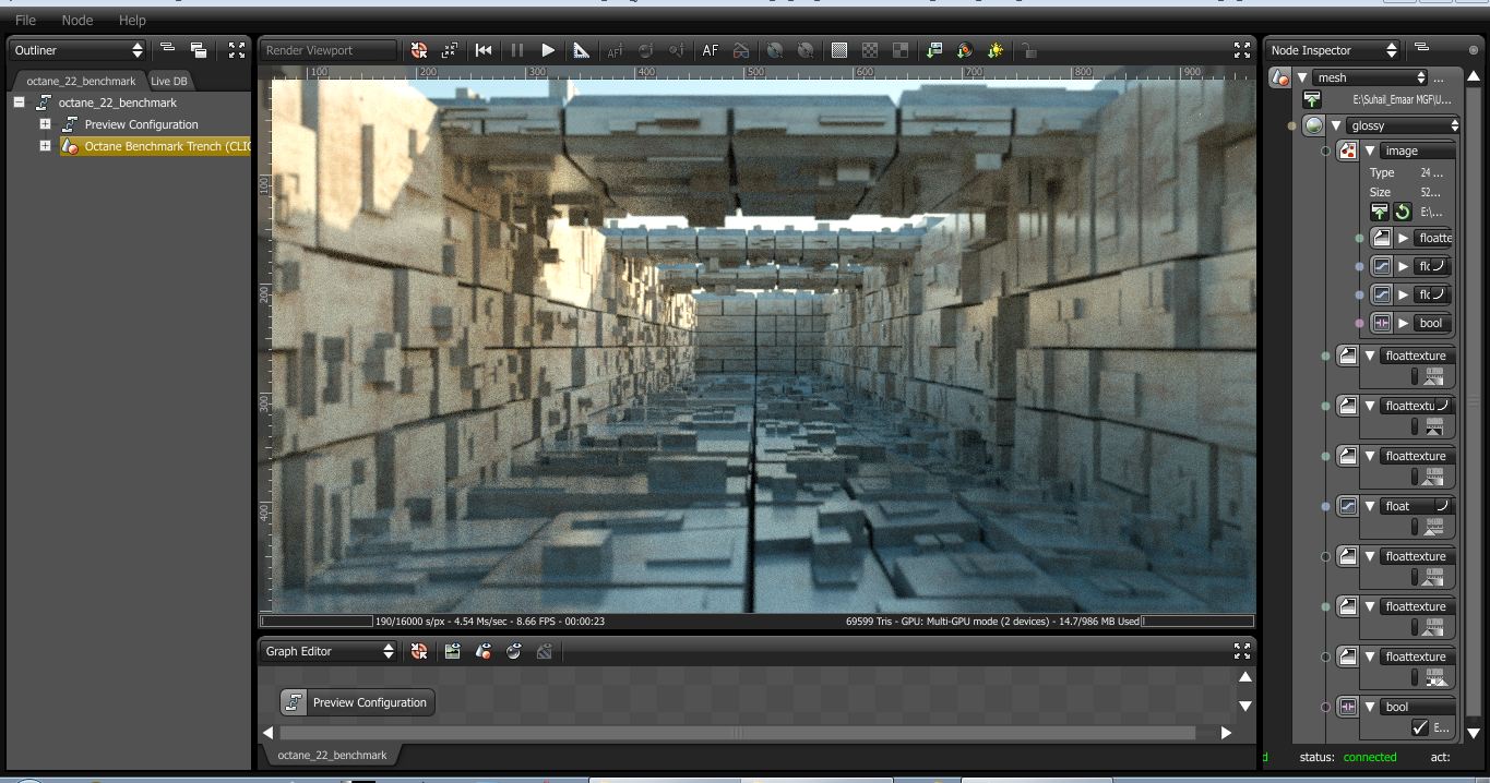

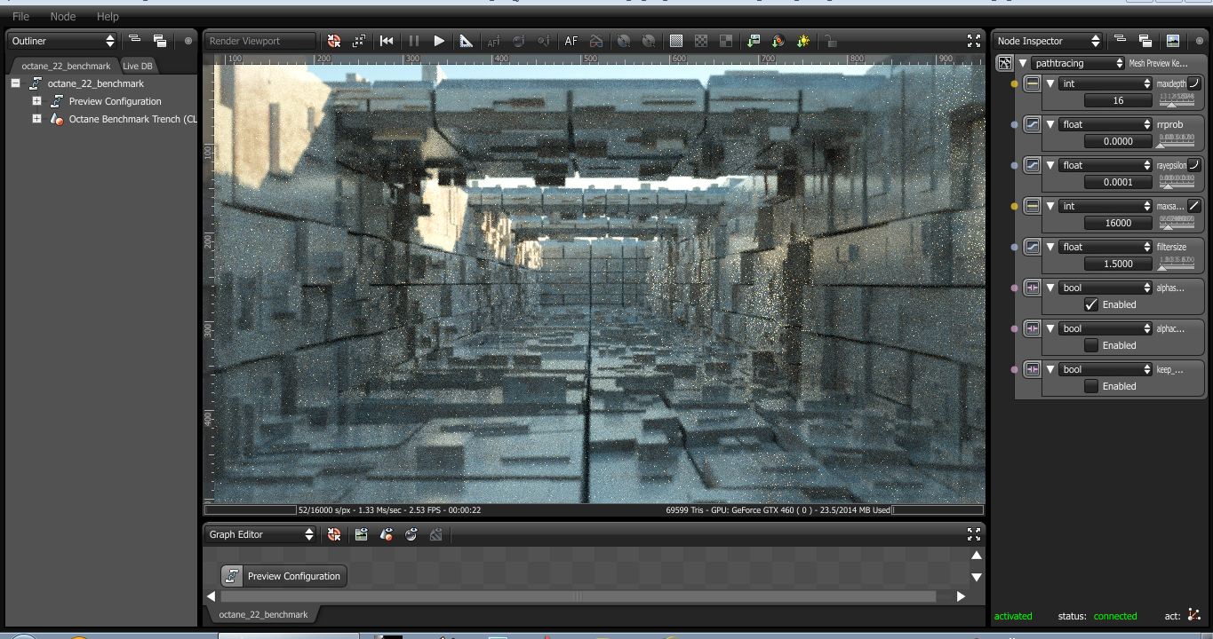

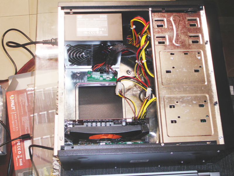

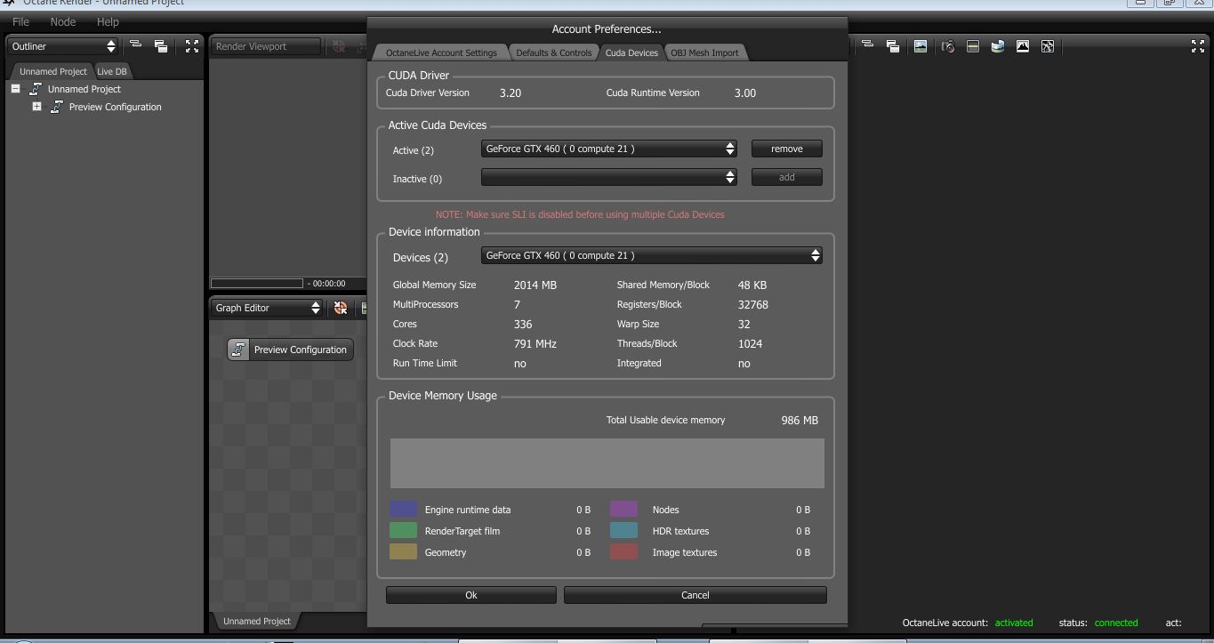

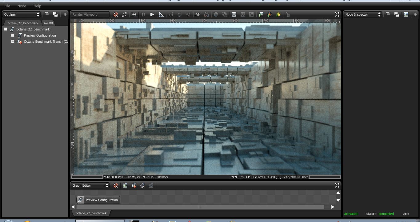

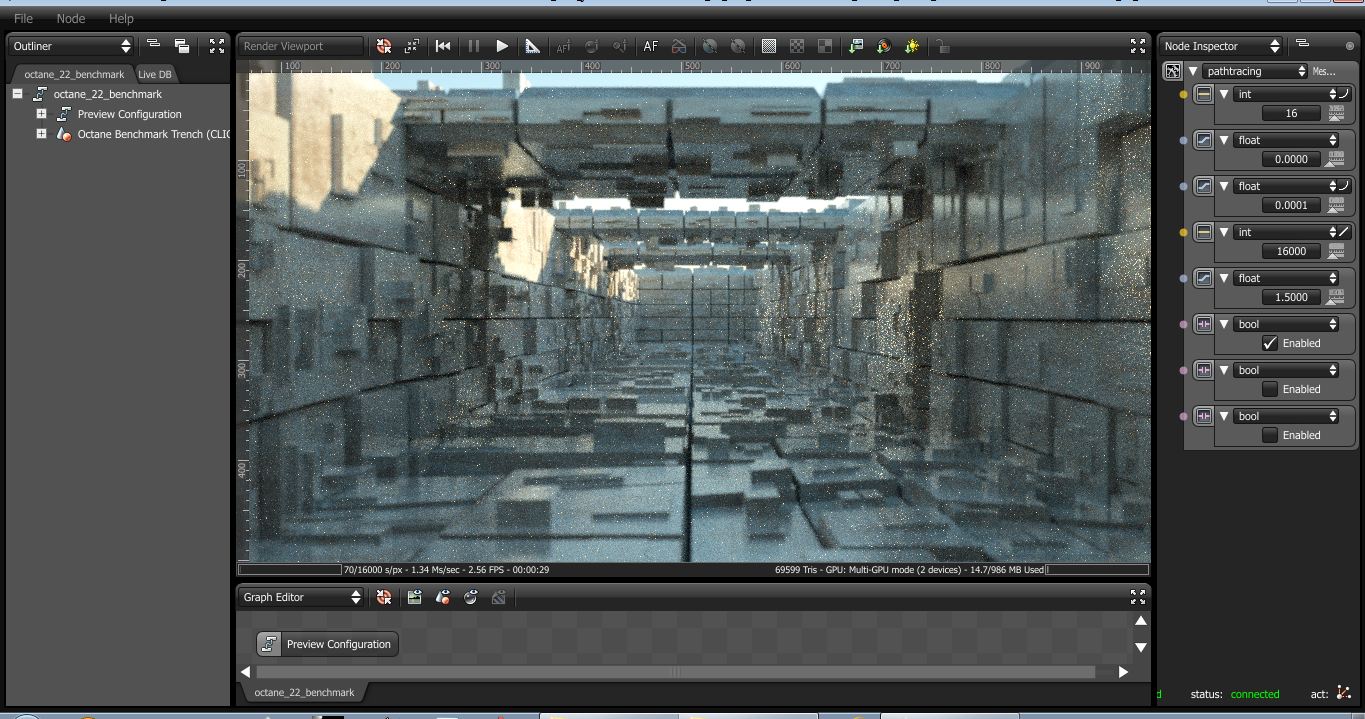

Finally... IT WORKS..
I was able to test out the PE4H kit, procured for 120 USD (including shipment).... with GTX460-2GB, assembled in a typical mini-cabinet, and a 500W Coolermaster Power supply....
Here are the benchmarks- with Cuda 3.2 (single GPU) and Cuda 3.0 (multi GPU) ....
followed by some pics of the rig...(i m not too good with these photos right now...can do better though
I DIDN'T NEED EXTERNAL MONITOR...- because my laptop has Nvidia Optimus
(more about Nvidia Optimus: http://www.nvidia.com/attach/3039887?ty ... rimitive=0)
DIY thread- followed for instructions to assemble the rig: http://forum.notebookreview.com/gaming- ... ences.html
and
http://www.techradar.com/news/computing ... tor-915616
where to buy the PE4H kit?
here:
http://www.hwtools.net/Adapter/PE4H.html
Installation was easy...
- just connect the PE4H adapter with the cables etc- as per instructions (in the DIY thread mentioned above.)
- plugin the graphics card, and join the 6 pin power connectors (2 nos, in this case)
- connect the PCIexpress card with cable and plug in to the laptop's PCIexpress slot...
- turn on the power- install hardware CD
- i had to install the latest nvidia drivers too
there are some known issues:
- works best with windows 7 (have some issues with vista, and can work with XP)
- does not work with mac (yet- as per the DIY thread...)
- may not work with some laptops at all ( as listed in the DIY thread)
- works best with 64 bit systems. With 32bit- can work- with some workarounds (for memory allocation issues.. exceeding 2GB ram..more details in DIY thread)
- you need PCIexpress slot in the laptops
- might need external monitor if laptop doesn't have Nvidia Optimus
it is hot-swappable, and no need to power off computer everytime... with windows 7- just need to turn comp to sleep mode- plug the rig- wakeup- go...
there is no need for external monitor if you have Nvidia Optimus on your laptop...(if not, there is monitor cloning with performance loss)
AND it is possible (i think so) to have multiple GPUs- with proper splitter adapters...(http://www.ameri-rack.com/ARC2-PELY423-C7_m.html) and adequate power supply...
it is a cheap alternate for Cubix- if this splitter adapter (http://www.ameri-rack.com/ARC2-PELY423-C7_m.html) is used- with multiple external GPUs running over PCIex1....
there are similar kits for desktops also- but i think the above mentioned splitter will work easily- without hassles...(if someone can test it out..) although I doubt that this splitter/riser can fit 2 double width cards..
cheers!

well...its been almost 2 weeks since i assembled my external GPU rig..
this is to share my experiences so far:
- it works fine...(like my laptop's got wiiiiiings....
- the cabinet gets warm- but not hot enough that i should get worried about
- it is somewhat hot swappable..means i just need to put my laptop to sleep mode- and connect the hdmi cable to the pcie adapter and start rendering right away..
- however, i need to shutdown the computer before i disconnect (or power off) the external GPU, or it gives a blue screen crash..but thats OK- i need to shut down before i disconnect- and I can live with that..
- it runs for 5-6 hours continuous- before my job is done (earlier i required my laptop to run for 18-20 hours to get around 1000 samples in pathtracing...but i now get the same in less than an hour ! i repeat- my laptop got wiiiings
- while the external GPU (GTX 460) is active, my laptop is available for any other work- on autocad,sketchup,gimp etc.. no crashes or speed issues so far (though AutoCAD 2010 does asks for onboard GPU to be active everytime a file opens- but its not a big problem anyway- and can be resolved)
i post some low- res images of some of the work done so far on this rig...(i wanted to post actual hires images which are 2000 pixels plus) but i wont be authorized to do so by my organization...
anyway..so far i think its a good solution for laptops (having pciexpress slot, and preferably having win7, 64 bit and nvidia optimus)...since i couldnt find any appropriate 'splitter' yet which can split multiple 'double width' PCIex16 slots- it still remains good enough for laptops though for a single external GPU (but hey..someone can still try multiple...
and maybe ask Cubix how do they do it
btw...the money spent on PE4H kit, power supply,cabinet etc paid off on day one itself
cheers!
