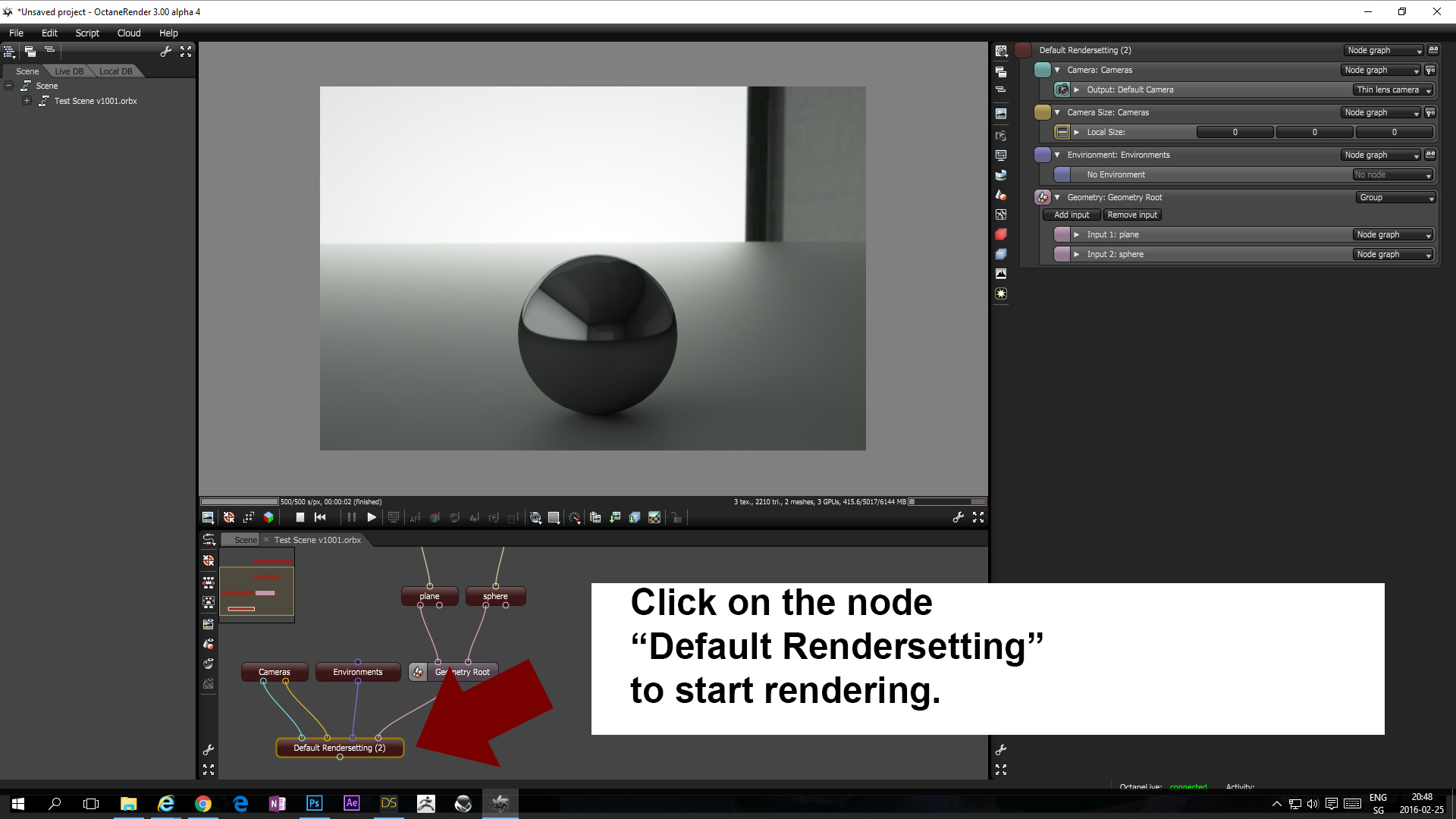

When you export from OcDS to OctaneRender standalone the "Render Target" node is calledSpectralis wrote:I'm not sure what a render target is or how/where to find it in the standalone.
"default Rendersetting"
or the name you gave your rendersetting in the OcDS rendersetting tab.

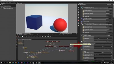

In any case in OR standalone
- check all the pin connections between the render target and the kernel node
- check if the sample values and limits per frame match those you had selected when rendering in OcDS.

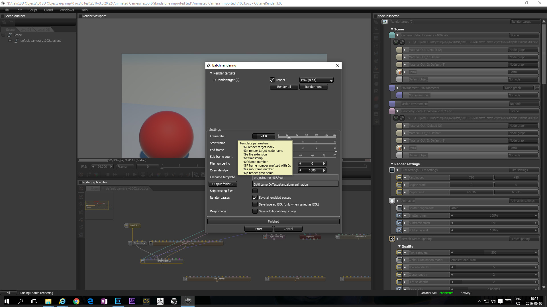

You can find the manual entry about the batch rendering script here:
https://docs.otoy.com/#60Batch%20Rendering
- Either rename the render target node to a name of your choice.
or
- remove the %n and any other values you do not want in your filename from the Filename template
or
- use this simpler filename template
projectname_%F.%e
Just add your preferred file name instead of projectname.
%F will add the frame number with a 0 before it.
. adds the dot before the
%e = file extension
