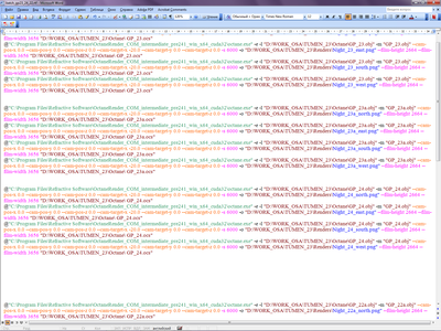

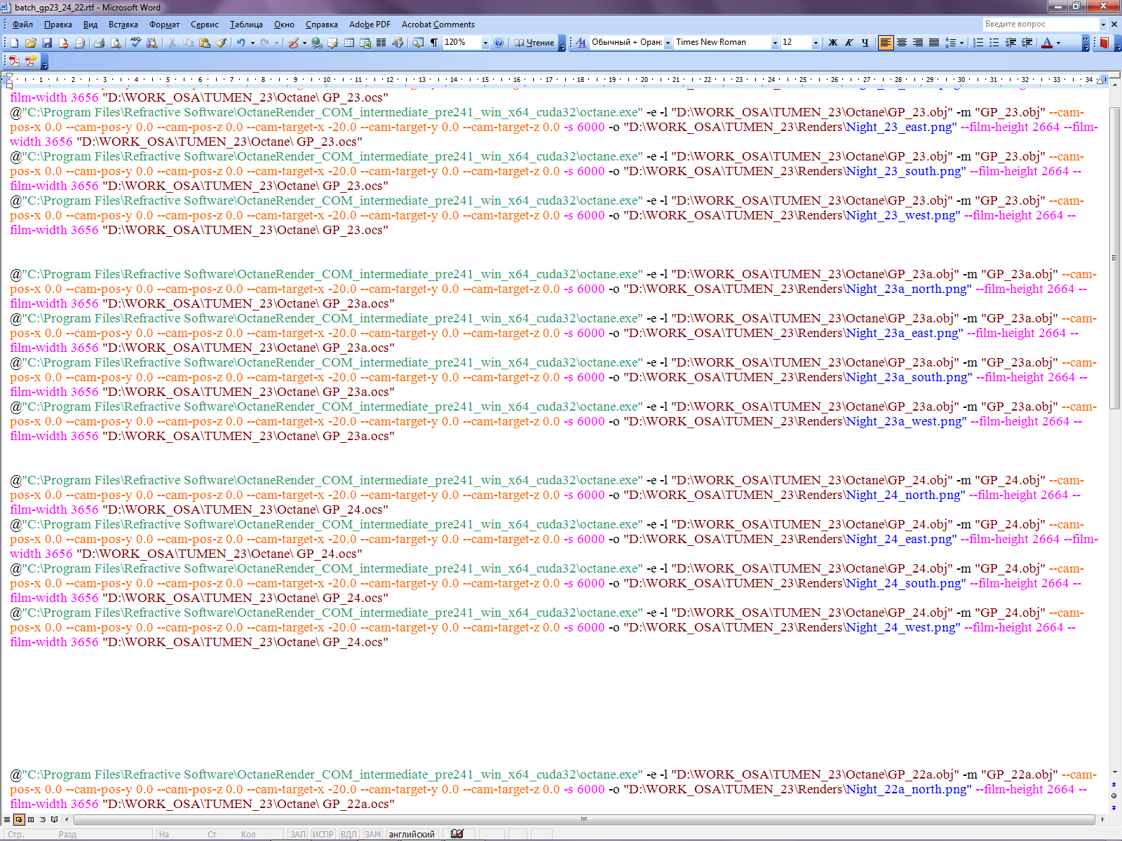

in 3dmax you can do the same trick that Abstrax mentioned. Just set 1 camera, animate it to set 1 frame for each different shot you want. (press the animate frame button, change to frame 2 move camera to new postion, repeat for as many shots as you need). And then use the script to render an "animation". That way Octane will render all your shots non-stop. This is great if you want the same resolutions for all your cameras.
If not use the command line and do a batch-render file were you can config each shot indepently. Open octane, setup your scene. Save one ocs file for each camera and tweak all your values, you can do it at lower res since you can change that later on the command line parameters. When you have all your scenes go to notepad, create one line for each render:
i.e. "C:\Program Files\Refractive Software\Octane\octane" -e -g 0 -m "objectnodemesh.obj" -s 4000 --film-width 6144 --film-height 1536 -o "renderoutputpath_with_filename.png" "scenefile_and_filename.ocs"
(you only need to use "" if your names have spaces)
Create as many lines as you want. For a complete range of swithes and what they do refer to the manual. Save the file somewhere as name.bat, execute it and go to sleep. I use it all the time to get all my shots and works great.
