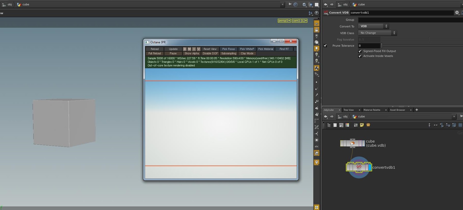

You can render the OpenVDB files loading them in Houdini and using the ConvertVDB SOP to render them like the native Houdini volumes, or you can use the native Octane OpenVDB loader, that is what you are using in your attached image.
In this second case, the OBJ node is only a placeholder, all the geometry available inside is not rendered at all. Also currently the plugin doesn't have a SOP node to preview the Octane OpenVDB files in the viewports. Anyway using this configuration, you could add a Houdini OpenVDB file SOP only to have a preview of the volume in the viewports.
Hello, thanks you so much. Your explanation of OpenVDB placeholder makes sense.
(1 )Okay, so now I'm interested in that native Houdini type, how to get the native Houdini volume showing in IPR. I connected via the ConvertVDB, but nothing. It must be something I am not doing, like in the case of a polygon cube, you have to first set to render as a Tessellated object and then assign a material in the Shop. Is there something like that with the native Houdini volume, where you have to assign it an Octane Medium material/texture...
does it also have to be set to render as a Tessellated object, and in ConvertVDB do you set it as a VDB, or a Volume...

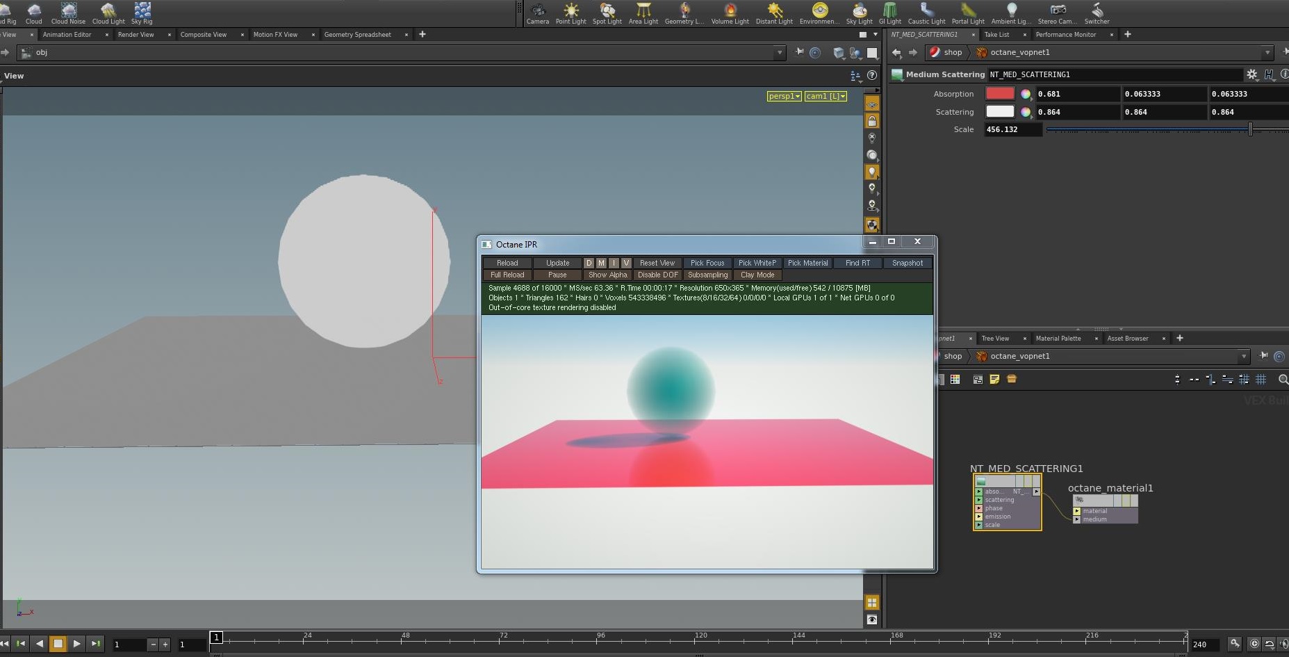

(2) what is the node called that lets you change the medium scale absorption, scattering, color, scale of a single vdb object (in either case of a native Houdini or Octane OpenVDB)

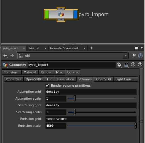

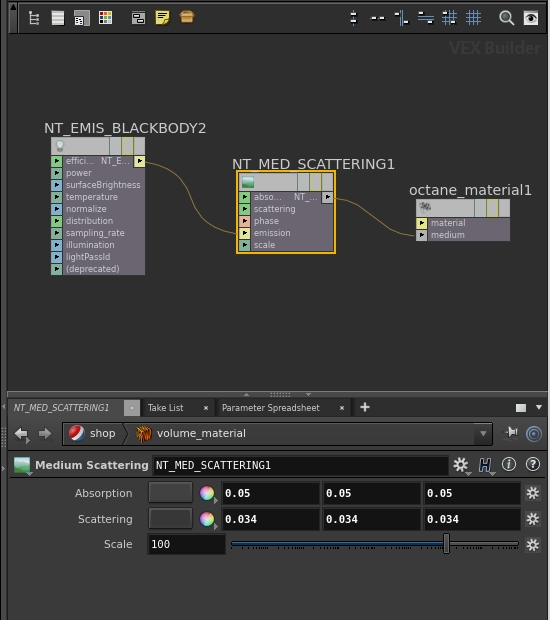

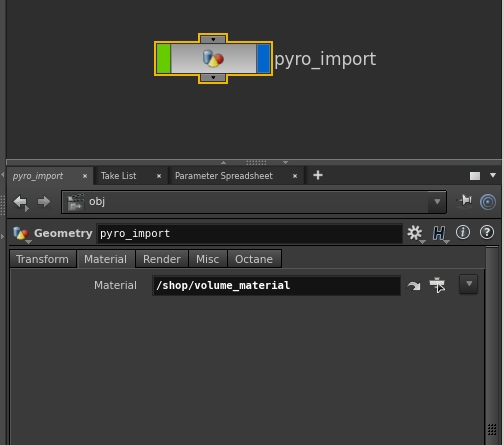

To render a native Houdini volume (for example a Pyro effect) you only need to add the Octane spare parameters and enable the Octane "render volume primitives" option. You don't need to convert them, they are already Houdini volumes compatible with Octane.
Later you only need to set a material in the volume OBJ node. This material must be a Octane network SHOP node with the Octane scatter node and the emission node (for emissive volumes) inside.

In your attached image, you must convert the file to "Volume" in the convert SOP node, not to "VDB". It is also a good idea enable the "split disjoint volumes" option.
-Juanjo
Notiusweb
Posts: 1285
Post by juanjgon » Fri Jan 29, 2016 5:57 pm
There we go! Thanks so much, I appreciate you taking the time. I know you are busy with the Lightwave release also.

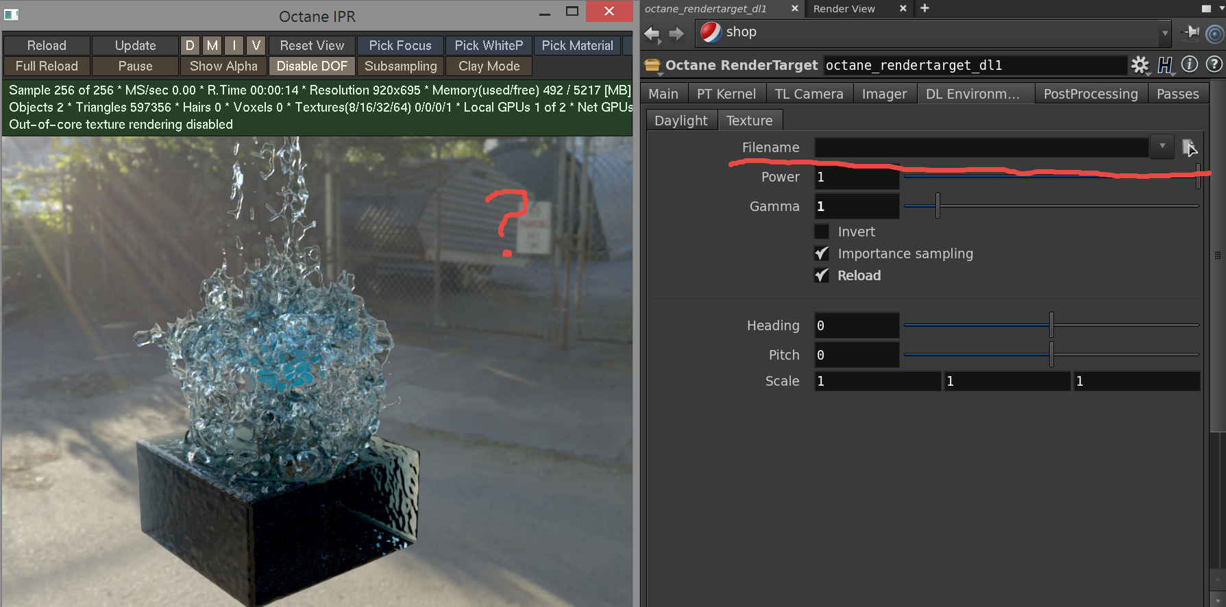

Daylight ENV
Texture ENV? Not Update Option.... :)

juanjgon
Posts: 8867
Location: Spain
Yes, I can reproduce this problem here. I will try to fix it for the next build. Meanwhile you can remove easily the image if you type anything as file path.
Thanks for reporting,
-Juanjo

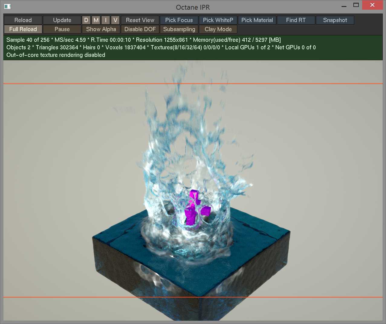

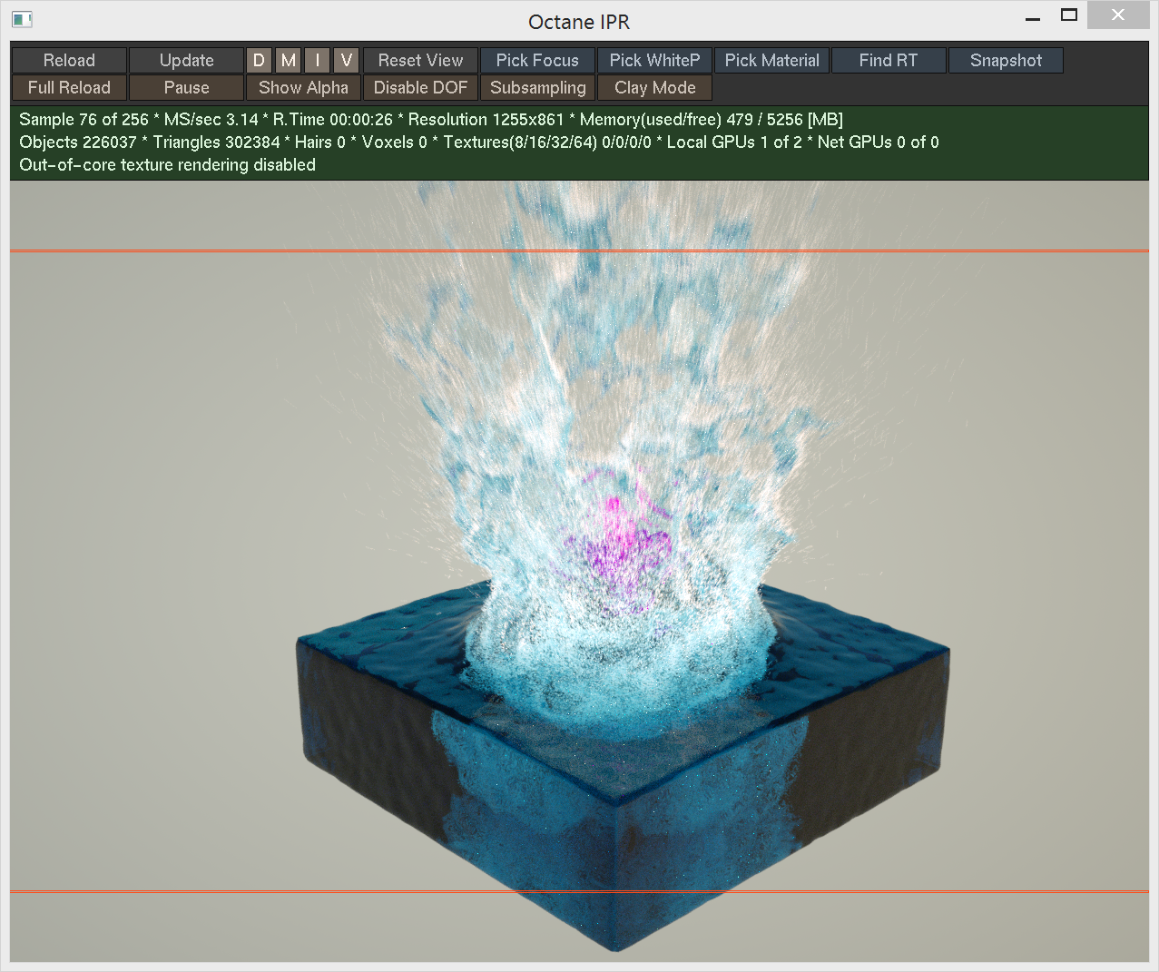

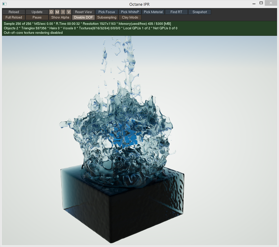

Whitewater Rendering. What is best way? :shock: NE1 Have good idea?
Instance Sphere
Volume Convert
C4D R2026 / Win11 / AMD TR WX Series / 256Gb RAM / RTX 5090 FE / 100GbE
