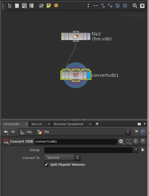

You can render the OpenVDB files loading them in Houdini and using the ConvertVDB SOP to render them like the native Houdini volumes, or you can use the native Octane OpenVDB loader, that is what you are using in your attached image.
In this second case, the OBJ node is only a placeholder, all the geometry available inside is not rendered at all. Also currently the plugin doesn't have a SOP node to preview the Octane OpenVDB files in the viewports. Anyway using this configuration, you could add a Houdini OpenVDB file SOP only to have a preview of the volume in the viewports.

Hello, thanks you so much. Your explanation of OpenVDB placeholder makes sense.You can render the OpenVDB files loading them in Houdini and using the ConvertVDB SOP to render them like the native Houdini volumes
(1 )Okay, so now I'm interested in that native Houdini type, how to get the native Houdini volume showing in IPR. I connected via the ConvertVDB, but nothing. It must be something I am not doing, like in the case of a polygon cube, you have to first set to render as a Tessellated object and then assign a material in the Shop. Is there something like that with the native Houdini volume, where you have to assign it an Octane Medium material/texture...
does it also have to be set to render as a Tessellated object, and in ConvertVDB do you set it as a VDB, or a Volume...
(2) what is the node called that lets you change the medium scale absorption, scattering, color, scale of a single vdb object (in either case of a native Houdini or Octane OpenVDB)
Sorry to be a PIA.
Thanks !!!!

To render a native Houdini volume (for example a Pyro effect) you only need to add the Octane spare parameters and enable the Octane "render volume primitives" option. You don't need to convert them, they are already Houdini volumes compatible with Octane.
Later you only need to set a material in the volume OBJ node. This material must be a Octane network SHOP node with the Octane scatter node and the emission node (for emissive volumes) inside.
