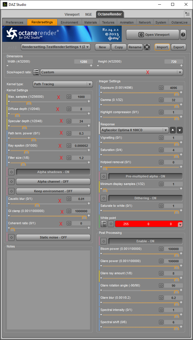

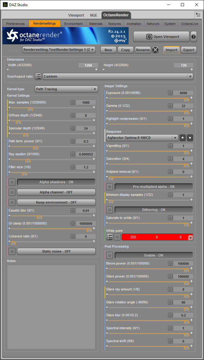

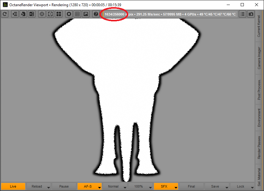

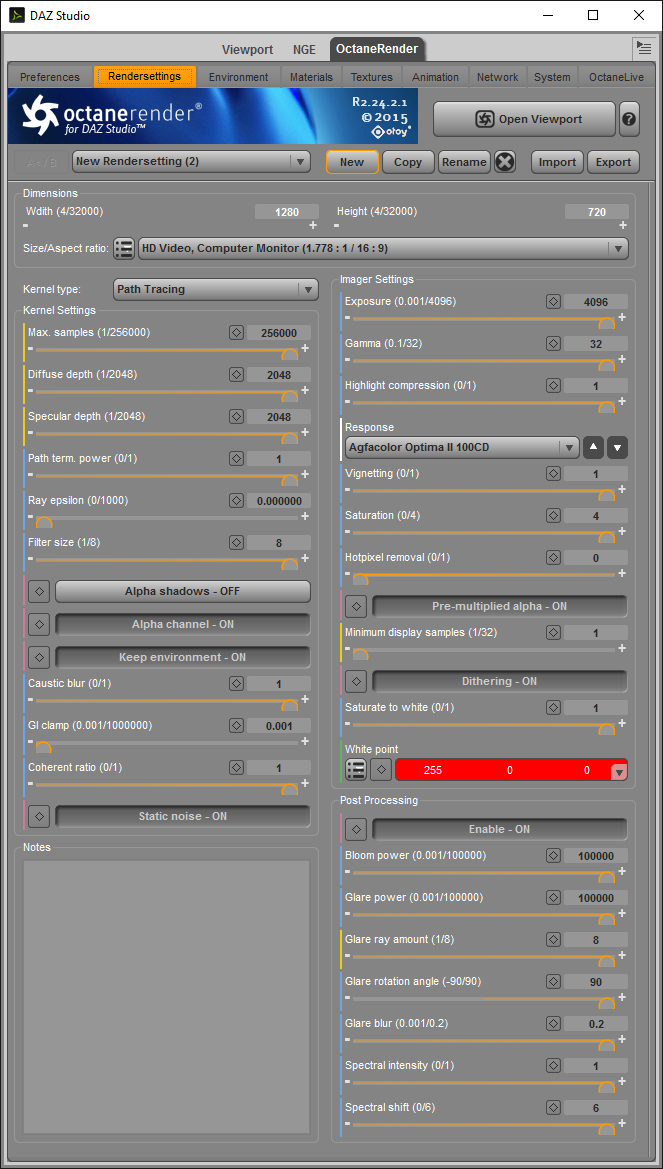

Hi Paul,
Issue with 'Render Settings' export / import. Some of the values change to default even though exported with modified values.
Below are the screen shots and the step by step instruction to create the issue.
1. Open New DAZ scene.
2. Go to OctaneRender->Rendersettings
3. Click New button and select Path Tracing as Type and click Accept
New Settings
New Settings
RenderSettings-DefaultRenderSettubg-PT-New Settings.png (6.54 KiB) Viewed 6430 times

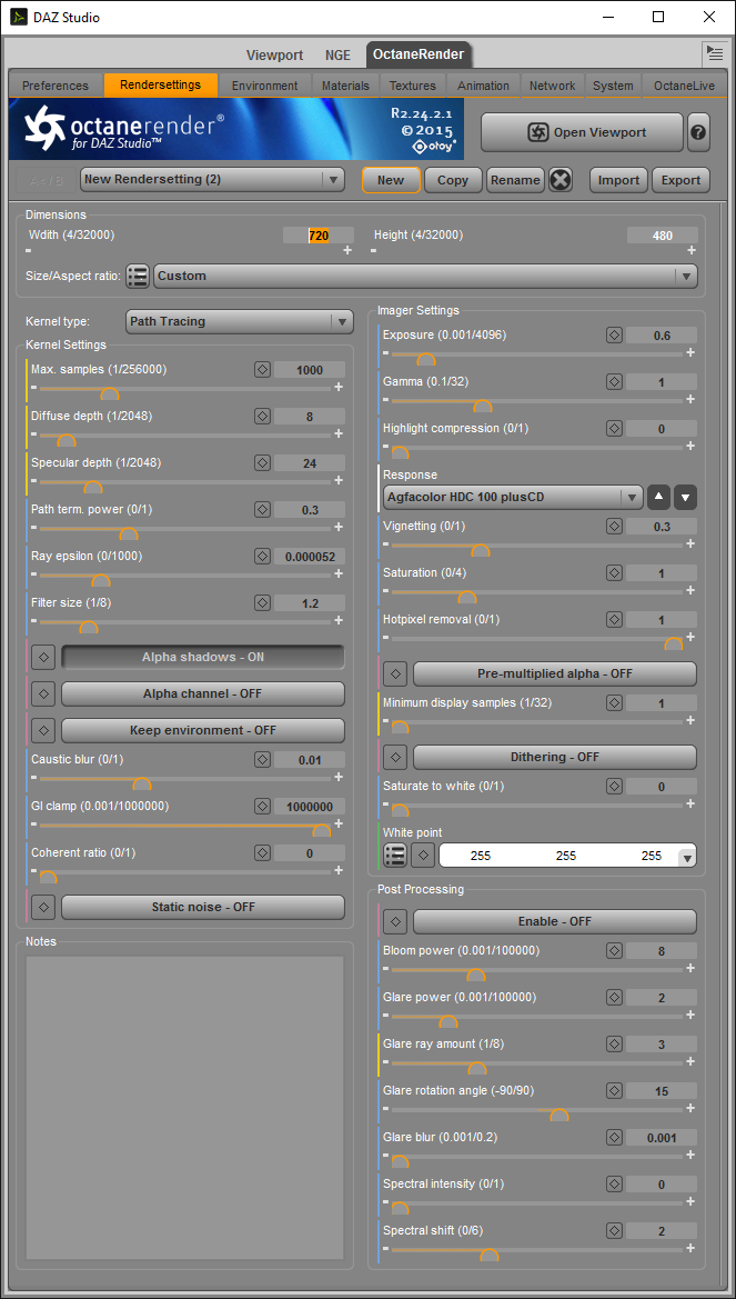

You will see the following default settings:
Default values
Default values
4. Modify all the values - Changes slider / values. Turn option on/off and export it.
Values changed and saved via export
5. Click New button and select Path Tracing as Type and click Accept as in step 3 to get the default values.
6. Click Import to import the exported settings.
Imported Settings.
Imported Settings.

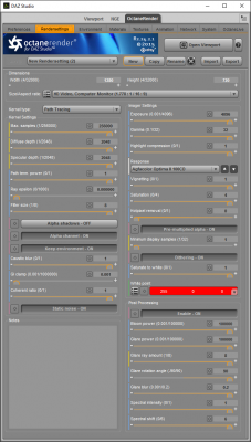

As you can see the values are different. I have marked as X the settings that did not have the exported value.
Wrong values
Wrong values
Similarly some of the values will reset for the PMC settings export/import. If you need screen shots for that let me know.
I think this should be a fairly simple bug to resolve. It either the export is not exporting some of the values / exporting wrong (default) values or the import is not reading those values correctly or reading it and then some initialization routine within the code is overwriting the values.

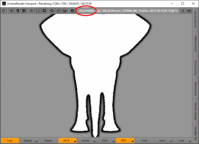

One other note. After importing even though the Kernel Settings -> Max Samples was showing 1000 after the import, on the render window, it actually showed the exported value of 256000. Changing the max samples in the render settings would not change this value shown in the render window.
Max Samples
Max Samples
The only way to get the max samples to work again is to select another Kernel Type and then change it back. After that changing the Max samples reflects in the render window. Other settings like Coherent ratio also get stuck until you change the Kernel Type to something else and back. The other settings might be stuck too after the import. Did not try all.
I think the values are being imported back, but somehow not being displayed properly and that in turn leading to the values getting stuck and changing them having no effect to the actual render.
Best regards,
Rajib

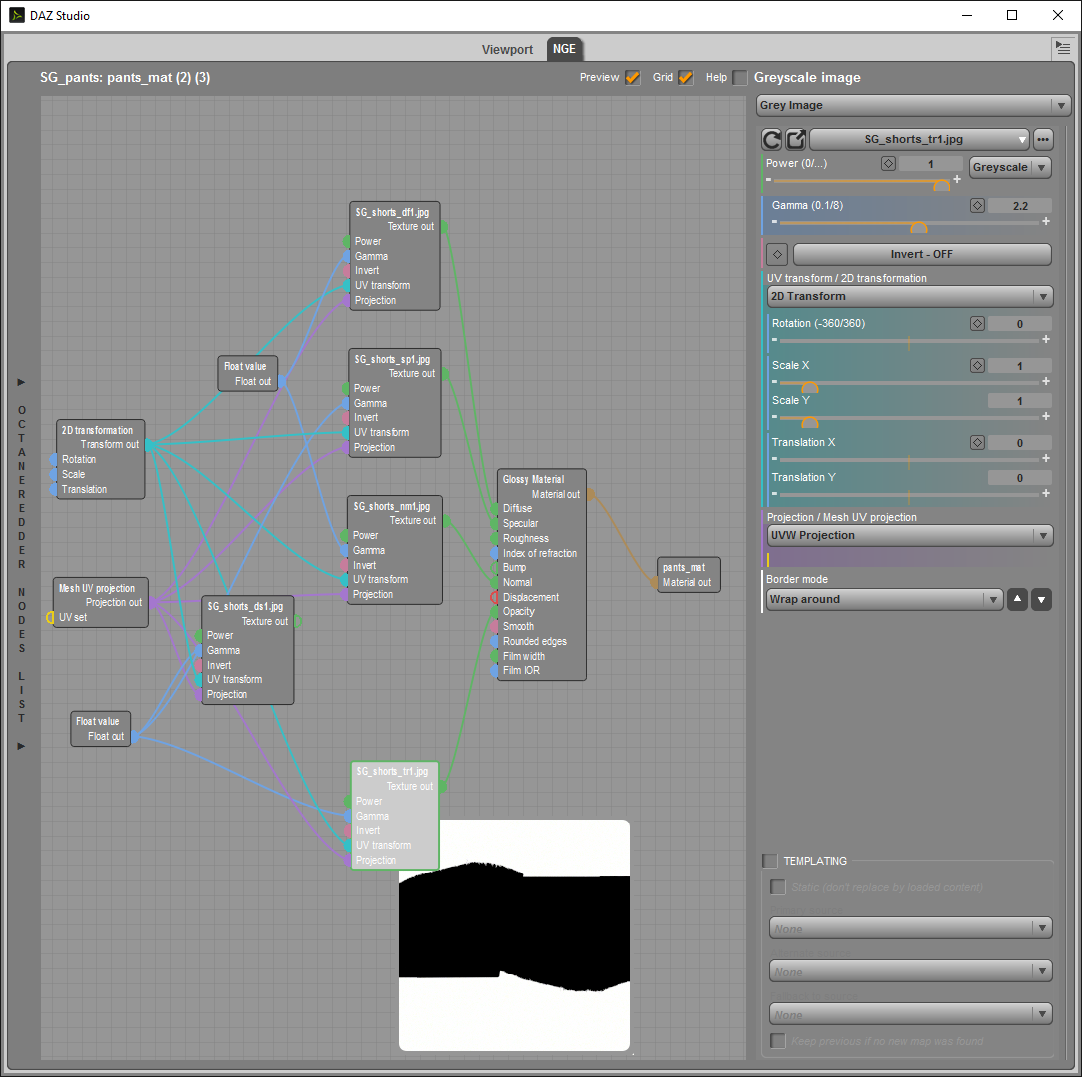

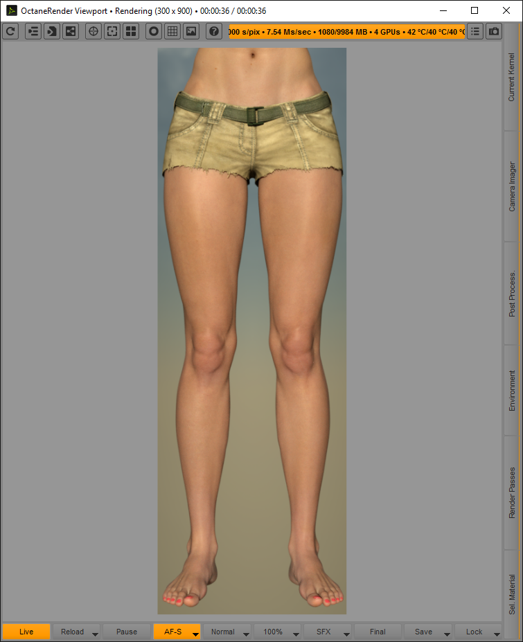

Hi Paul,

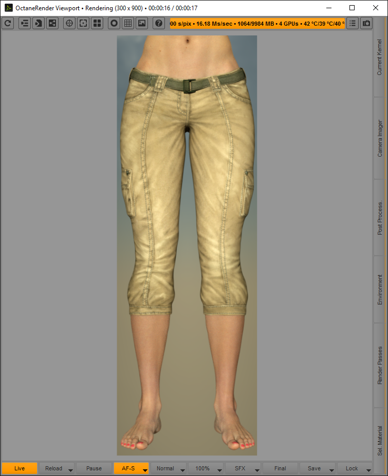

Another issue. With Opacity Maps. I have my base model wearing a pant that has a transparency map to convert the pant into shorts.
Original pant without Opacity map :
Original Pant without Opacity Map

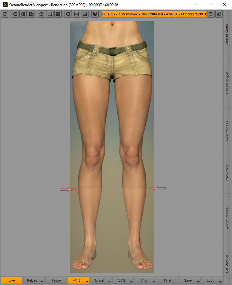

Pant with Opacity map applied :
Pant with Opacity Map
As you can see even though the Opacity map does it's job, there is a 'dark' layer wherever the actual pant covered her legs. Marked with the red arrows. Anything the original pant did not cover is normal, but between the bottom edge of the shorts and the red arrows, the skin looks darker. The alpha shadows appear properly based on the Opacity map.
Opacity settings are :
Opacity settings
Opacity settings
The transparent part is black (0,0,0) and the power and gamma is correctly set. So that 'darker' layer should not be there.

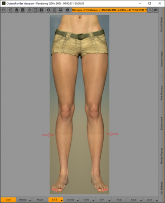

At first I simply could not figure out what was causing it. Finally found that if you have multiple Specular Material node in the skin material (I am using Tonysculptor's skin material) , what values you have in the Medium in each of the node results in that. If they have the same value, then the issue does not appear. But if the Medium node entries are different, with the the opacity map present, the darker layer appear wherever the transparency map was pure black.
With All Medium node of the Specular Material set to the same value it appears ok:
Transparency OK
Transparency OK
Not sure if this is an Octane issue instead of the DAZ Octane Plugin. If there is an Opacity mask present and the transparent parts are pure black (0,0,0) shouldn't it be fully transparent and not have any effect irrespective of whether the material used is specular or glossy or diffuse ?
Best regards,
Rajib
This is definitely not an OCDS plug-in-issue.
It's like that in every version of Octane, since you control light / transmission absorption with those medium nodes.
Setting these to individual values, on a character consisting out of more than 20 materials (Genesis2) is bound to give these errors.
Not a bug, hence doesn't need to be fixed.
