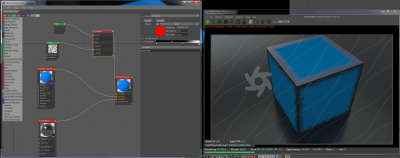

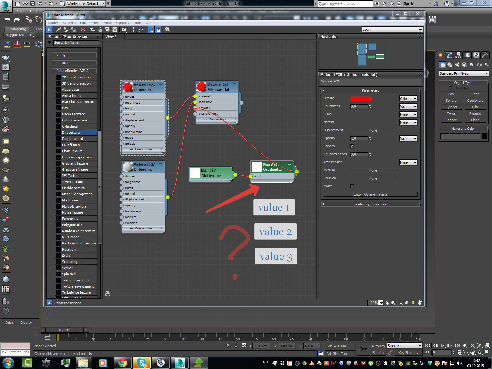

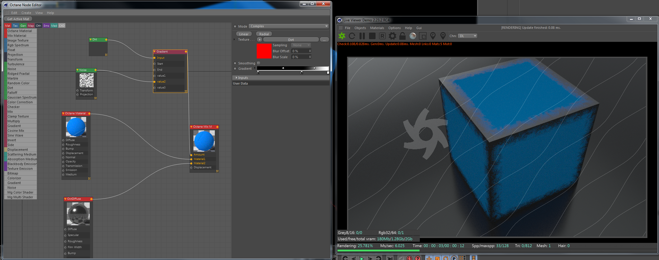

Why there is no integration of these functions?
gradient is useless

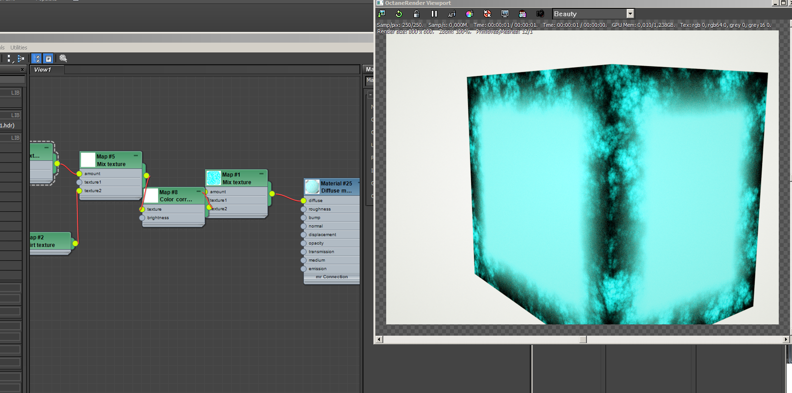

mat
not correct but still you can implement
New Library.rar
(2.57 KiB) Downloaded 347 times

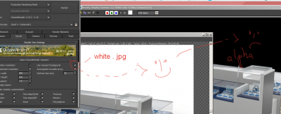

ban alpha channel when you turn your support background
The alpha channel works in any case when I try to set the background when you transfer from octane viewport in 3Dmax viewport standard

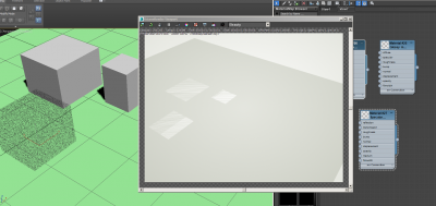

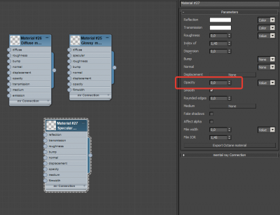

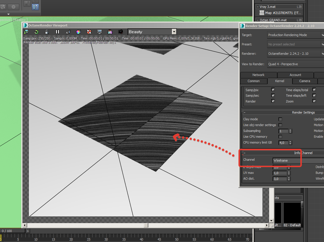

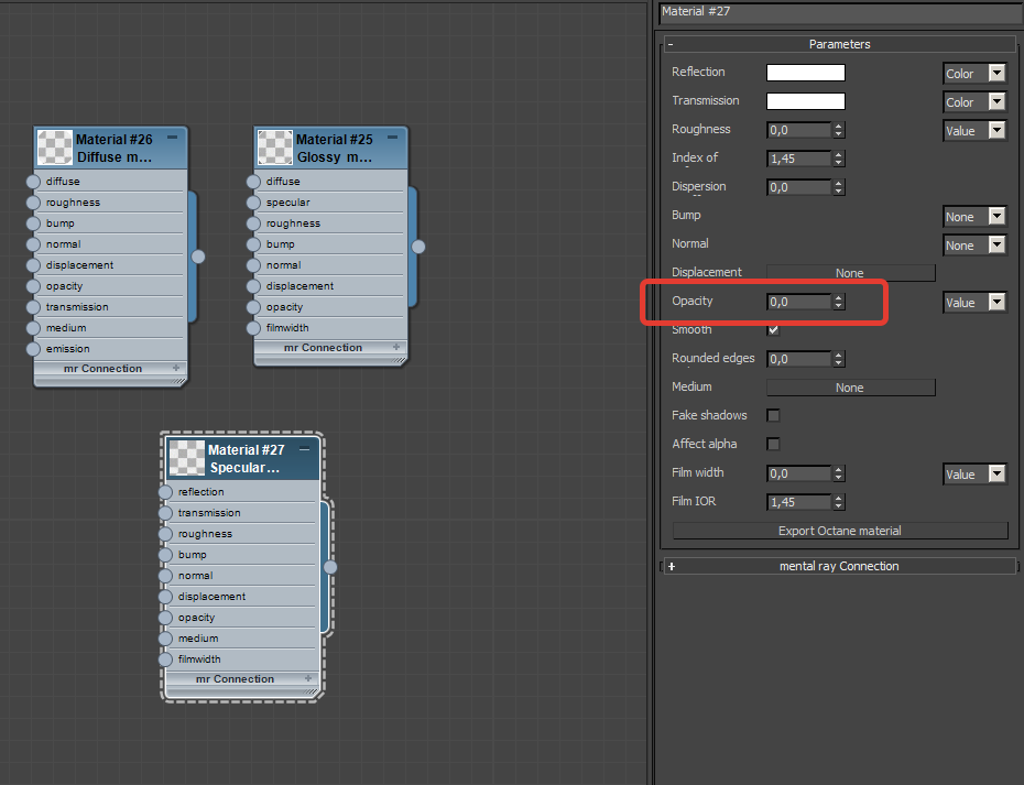

The problem of artifacts.
1. I create three diffuse material gloss material and specular material . All of them, I do oppacity 0
2. distribute the materials for the three models are butt ie 1 the model surface in contact with the floor surface and their distance is 0
3. each of these items assign materials in turn and in time render get these artifacts, I note that Ray Epsilon 0.0001
4.the same problem occurs and when I object to translate properties invisible in the camera
thank you for your attention hopefully this artifact will be fixed soon .
gabrielefx
Posts: 1701
Joined: Wed Sep 28, 2011 2:00 pm
you can have two polygons sharing the same 2d space except when you enable transparency or there is zero thickness. It causes flickering during animations. This is valid also in the rt game engines.
For me this is the rule #2.

so this problem is unsolvable with this render ?
3dgeeks
Posts: 193
Joined: Wed Jun 11, 2014 8:12 am
Goldisart, I suggest you push the geometry a very small amount through the base surface. This problem happens with most renderers as Gabriele says.
