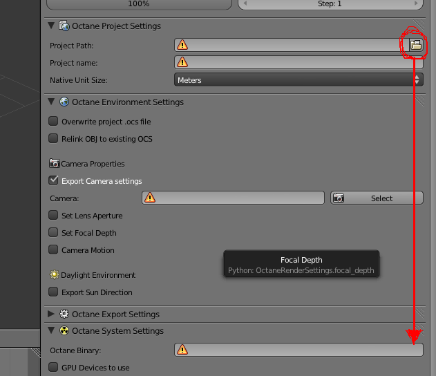

Fixed with v0.42. Thanks for pointing out this, I should have better tested while playing with UI properties
