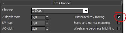

I just noticed this, the MAT-ID channel - maybe others too, render without respecting the DOF of the beauty pass. The wrongly rendered channels were the ones specified in the render elements.
When I switch my engine to info-pass and render MAT-ID, It's perfect.

Turn On Distributed Ray Tracking

pepasystem wrote:Turn On Distributed Ray Tracking
This didnt work when rendering as a pass rather than as an info channel.
I think it would be good to be able to render out a mask just for 1 ID with motion blur. Currently render layers removes the masked part from the render, which is generally not what we want.
