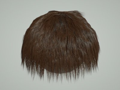

There has been some discussion about getting nice looking highlights over at the DAZ forums. I came up with what I think is a nice looking shine to the hair, using Octane's Glossy with Index 1.3, Specular 1.0 and Roughness 0.2. Sighman, I wonder if it would be possible to adjust the auto-shader conversion specifically for hair so that it is possible to get a similar result from the default Carrara Hair shader? That would make things easier and more intuitive.

I was just waiting for someone to come up with the right numbers.PhilW wrote:There has been some discussion about getting nice looking highlights over at the DAZ forums. I came up with what I think is a nice looking shine to the hair, using Octane's Glossy with Index 1.3, Specular 1.0 and Roughness 0.2. Sighman, I wonder if it would be possible to adjust the auto-shader conversion specifically for hair so that it is possible to get a similar result from the default Carrara Hair shader? That would make things easier and more intuitive.

As my tests used Specular set to 1.0, you can use the Index figure to increase and decrease the amount of shine, and the Roughness to change the Spread of the shine (lower roughness = tighter shine area).Sighman wrote:I was just waiting for someone to come up with the right numbers.PhilW wrote:There has been some discussion about getting nice looking highlights over at the DAZ forums. I came up with what I think is a nice looking shine to the hair, using Octane's Glossy with Index 1.3, Specular 1.0 and Roughness 0.2. Sighman, I wonder if it would be possible to adjust the auto-shader conversion specifically for hair so that it is possible to get a similar result from the default Carrara Hair shader? That would make things easier and more intuitive.

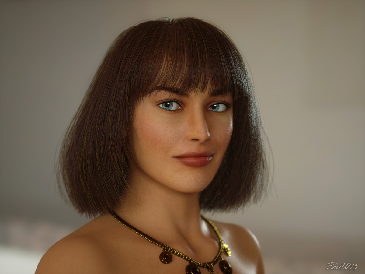

Amazing.PhilW wrote:Did I say how much I am loving having Carrara Hair rendering in Octane!!
So is that what you mean by duplicating the hair prop? It looks like there are two hair colors in there, or is that just lighting?

Yes, the second hair is a dup of the first, reduce the number of hairs, lighten it a little and add some frizz to create flyaways. I used to do it in Carrara but it always produced artifacts, so I always needed to render both with and without the second hair and combine them in Photoshop. But Octane is handling it flawlessly. Actually I think the second colour in this is a little too light so it doesn't blend as well as it should. But you can envisage using perhaps several copies to get some natural colour variations going - until you get the UV mapping thing sorted out of course!Sighman wrote:Amazing.PhilW wrote:Did I say how much I am loving having Carrara Hair rendering in Octane!!
