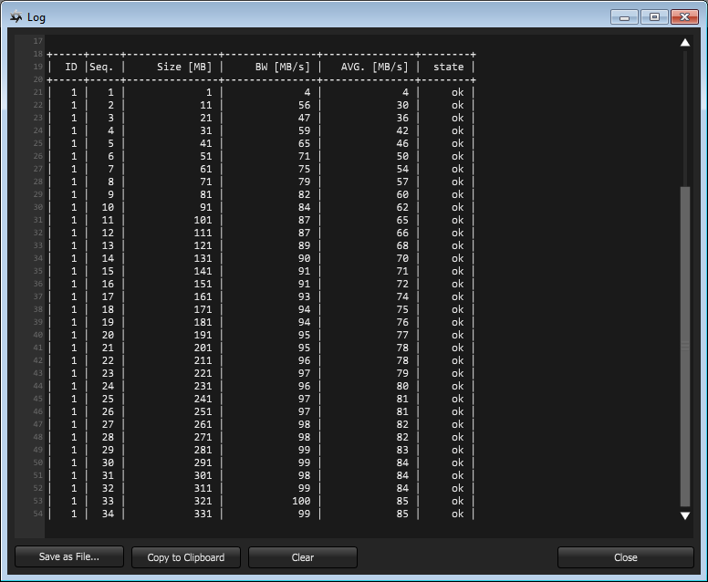

sorry, the screenshot I made was just using localhost, which is much faster than LAN. In the office we have a 1 Gbit/s LAN set up and that's what I get:
In other words, I achieve about 100MByte/s and with very large packets up to 105MByte/s, which is as expected.
So, lksmada your connection seems to run with 1Gbit/s, otherwise it should be much faster. I'm no expert in those things, so I don't have a good list of instructions how to figure out, where the problem is, but Google probably knows more. On the other hand, 100MByte/s is not too bad, so I'm wondering if there is not something else going on. How does it behave in small scenes (i.e. less than 1 million triangles and only a few small textures)?
Mike, your stats indicate you are not running with the full 1Gbit/s, but it isn't that bad that it would explain the times you experience, so there is likely something else going on here. Could you test it with a small scene (i.e. less than 1 million triangles and only a few small textures)?

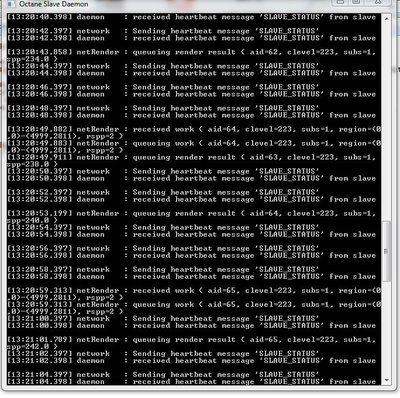

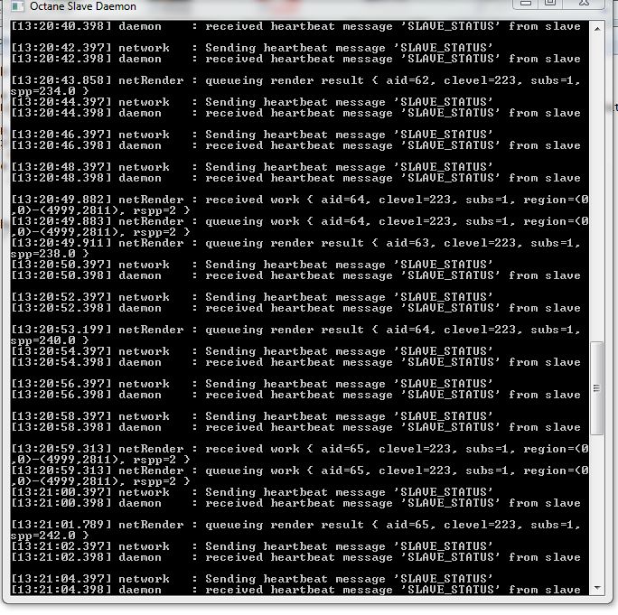

Posts: 783
Joined: Sun Jun 06, 2010 3:00 pm
Hi Abstrax,
strange - don't know why - but its working now!
Now when rendering , for the first time, I see this activity
in the Slave-Daemon-Bat.
On the Master there is still status "updating" and still I cannot see,
that there is something going on, but rendertime now is half the time
than without network-rendering.
So, god thanks, its working now!
Next I'll try again with a bigger scene and will report.
thanks
Mike
