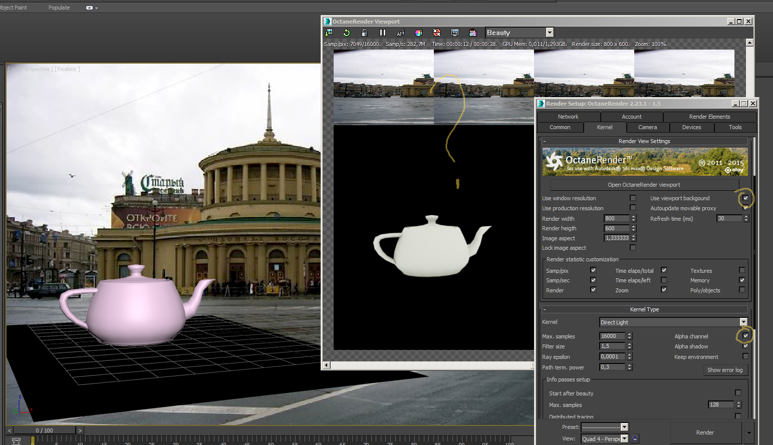

Goldisart
Posts: 780
Joined: Sat Oct 26, 2013 8:47 am
use vieport background
maybe I don't know how to do this correctly if anyone knows how to solve my problem write

JimStar
Posts: 3852
Goldisart wrote:use vieport background
Looks like bug. I'll check it, thanks for report.
