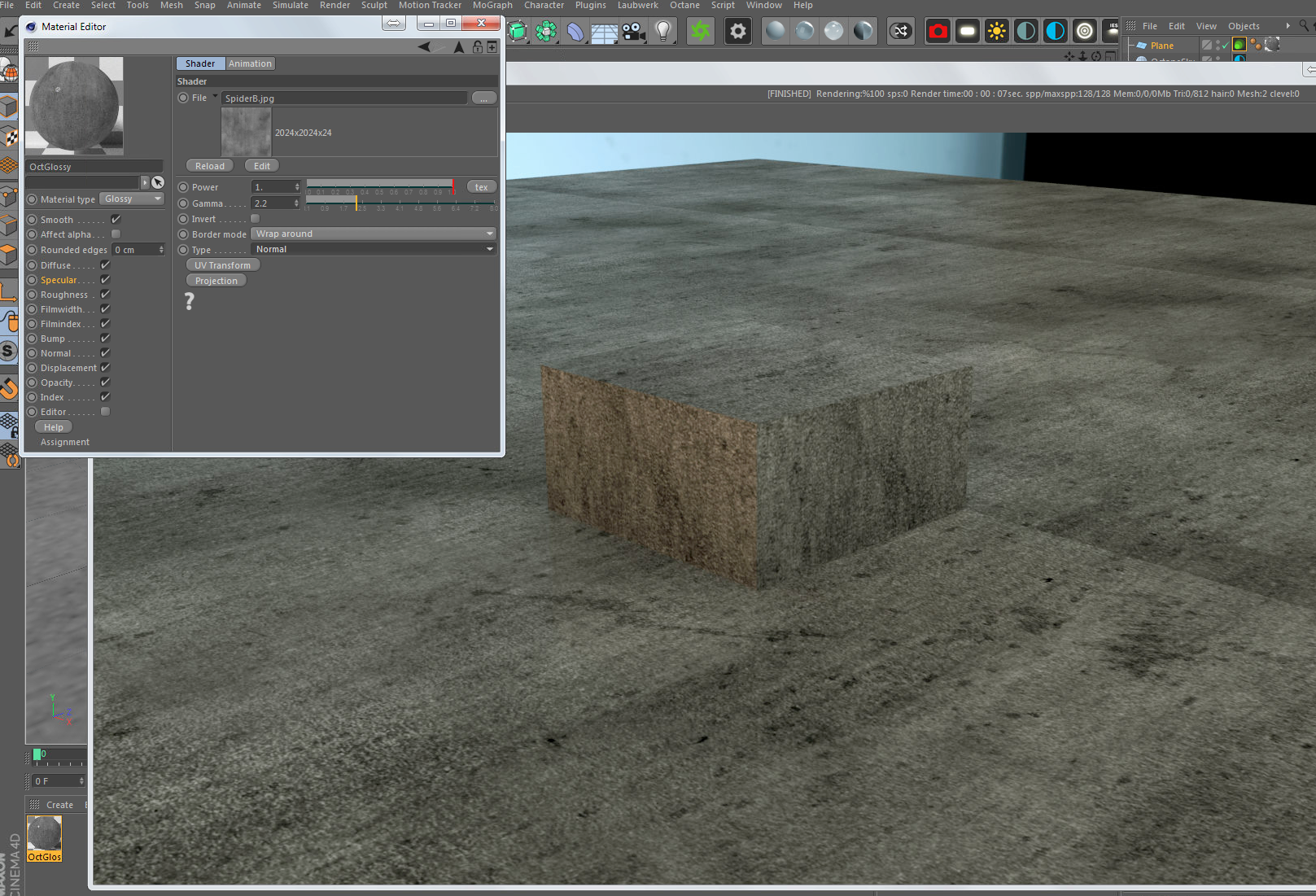

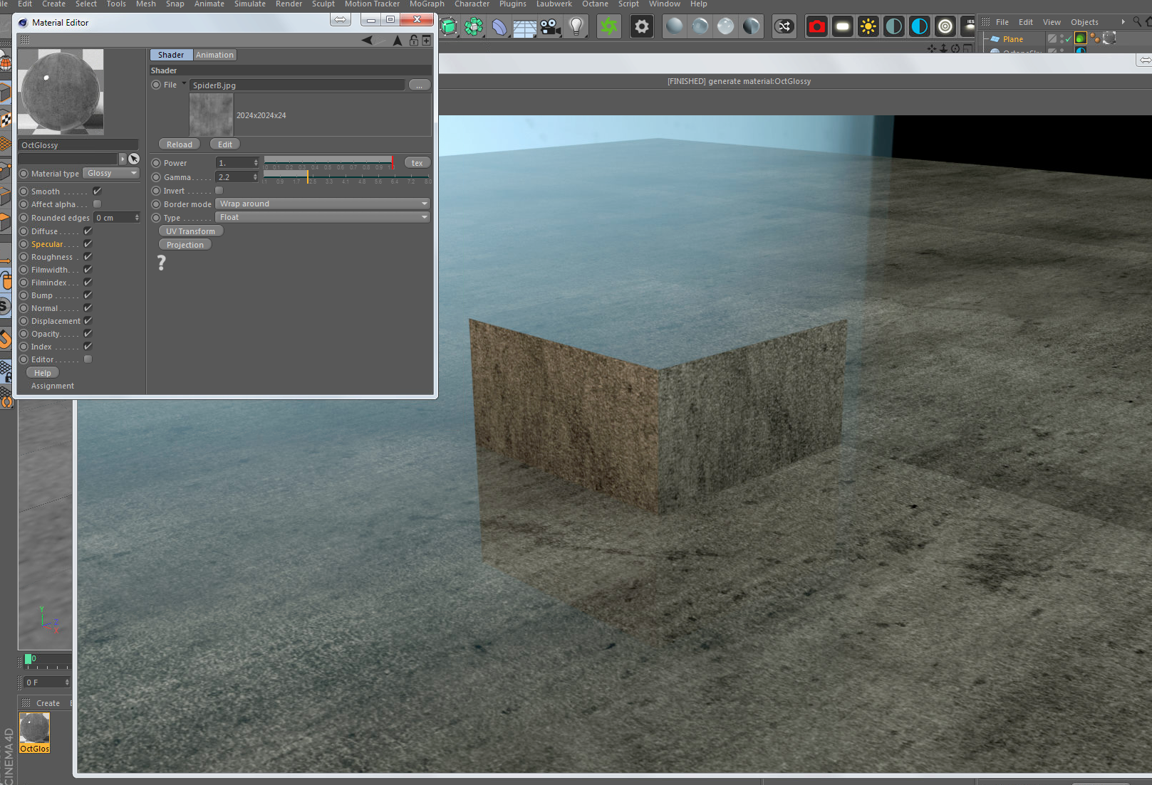

aoktar wrote:
martincarlson wrote:Also:
Texture slot on Roughness have no impact anymore if it is set to Float? Only if i change Power settings. Gamma have no impact.
If I change to Normal - it works just like before. Bug?
Same thing on Specular texture. Maybe all?
I can't see any problem. What's this? I need a sample to see....
Check this out:
Here's specular set as NORMAL:
Specular set as FLOAT:
Which means all my old scenes behave strange.

Hi martincarlson,
check my previous message. It's a bug on RC1, please try RC2
martincarlson
Posts: 319
Joined: Mon Nov 03, 2014 10:18 am
Location: Sweden
aoktar wrote:Hi martincarlson,
Ahaaa. Missed that mesage. Thanks. Just noticed that in Standalone FLOAT turns up as ALPHA. That explains it.
