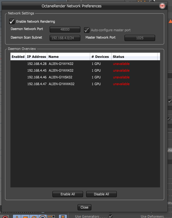

I'm getting this randomly and have to uncheck and recheck the box for use network rendering. Also, sometimes one client may fail without any errors on a slave (I'm guessing one is failing) and the render just stops and freezes c4d. This has been happening a lot, even in 2.16+. Should I manually pick the port? Will that maybe fix it? It also freezes on the first frame, quite often and I have to restart it. Almost like it's trying to connect to a slave and when it doesn't the frame gets stuck at 99.x%. Also I thought you changed the info at the bottom to be able to show everything? I can't see slave numbers or other info when rendering at 800x600.
By the way, it's also failing a lot when I use the render queue. It may render 50+ frames fine and sometime after I leave for the night it stops and a long line of animations never even start because of it. I'd like to figure this out as it's going to cause me a HUGE problem next week when I'm overloaded with renders.
