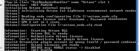

From my best guess it looks like the license config file is not being read correctly? Should it have ******* for the username too? Or maybe even the actual username. This is probably the issue.....

Does the username pass need to be in the quotes? Maybe that's the problem?

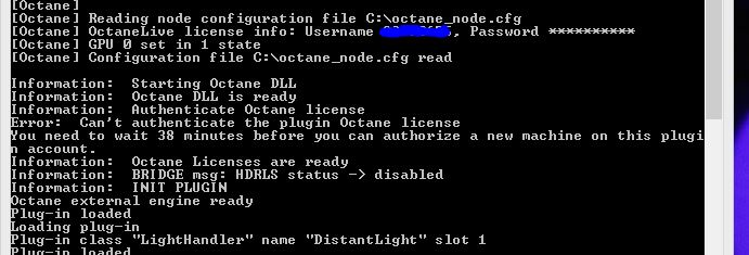

It appears the username and pass must be within the quotes...as this setup works. Or will work, I CANT ACTIVATE MY LICENSE FOR ANOTHER 38 MIN. Seriously....Terribly restrictive and redundant....if we must have an internet connection to talk to octane servers, why then also require a wait period. They can only have one machine active at any one time anyway....let the artists actually USE THE SOFTWARE!!!!

1. A Stand alone + LW plugin license is needed for each MACHINE they want to render with.
2. A octane_node.cfg file is needed at the root of the C:\ drive for each render node. The username and password need to be in parenthesis. (this is crucial)
3. Each of these render nodes needs an activated OctaneLive account.
4. If you use LW and want to use LWSN network rendering ON THE SAME MACHINE, but not at the same time, there is no additional license needed. Nor do you have to DEACTIVATE the plugin license before starting a LWSN network render on THIS SAME MACHINE.
5. In this one machine that has a standalone and plugin license you are limited to 12 GPUS...whether LWSN is doing the rendering or LW native.
6. Butterfly Net Render Controller works perfectly (as far as I can tell at this point) with Octane. There is nothing to configure or additional scripts to prepare. Just have a working LW config in BNR that has the plugin files in the lwext file and your good. Each node as mentioned above will need a full combo license and a octane_node.cfg in the root drive with appropriate username and password for OctaneLive account.

Yes of course....in my haste and excitement I said the wrong thing. Quotes it is....Thanks!juanjgon wrote:I am glad that it is working now
Only a little correction: The username and password need to be in quotes, not in parentheses
-Juanjo
