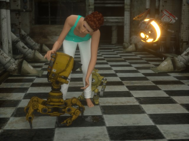

Sighman, was playing with a Daz Studio scene I loaded into Carrara, apart from some geometry issue with clothing which I have to address with the Carrara Team the question was more about some materials I applied with the new material interface. Once a material is applied to a surface there appears no easy way to revert.
I was trying to add light source to the center eye piece and missed, so it added it to the band on the floater bot.
Carrara cambot
Carrara cambot
