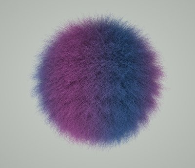

"One important feature of the Octane plugin is that each fiber inherit the UV coordinate available in the base mesh at the fiber root point. This feature makes possible apply texture maps to the hairs, as you can see in the next image."

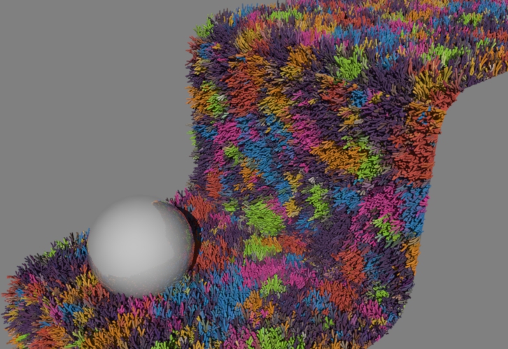

Could we hassle the octane team to include the same functionality for instances ? As in an instance picking up the UV from the instance location point?
At the moment we can only do planar & camera projection and that means things like this (pic) which are now possible with FFX, are not possible with instancing.
One fiber instanced a bunch of times, one mesh with UV and one splotchy image on the mesh. Cheers.
