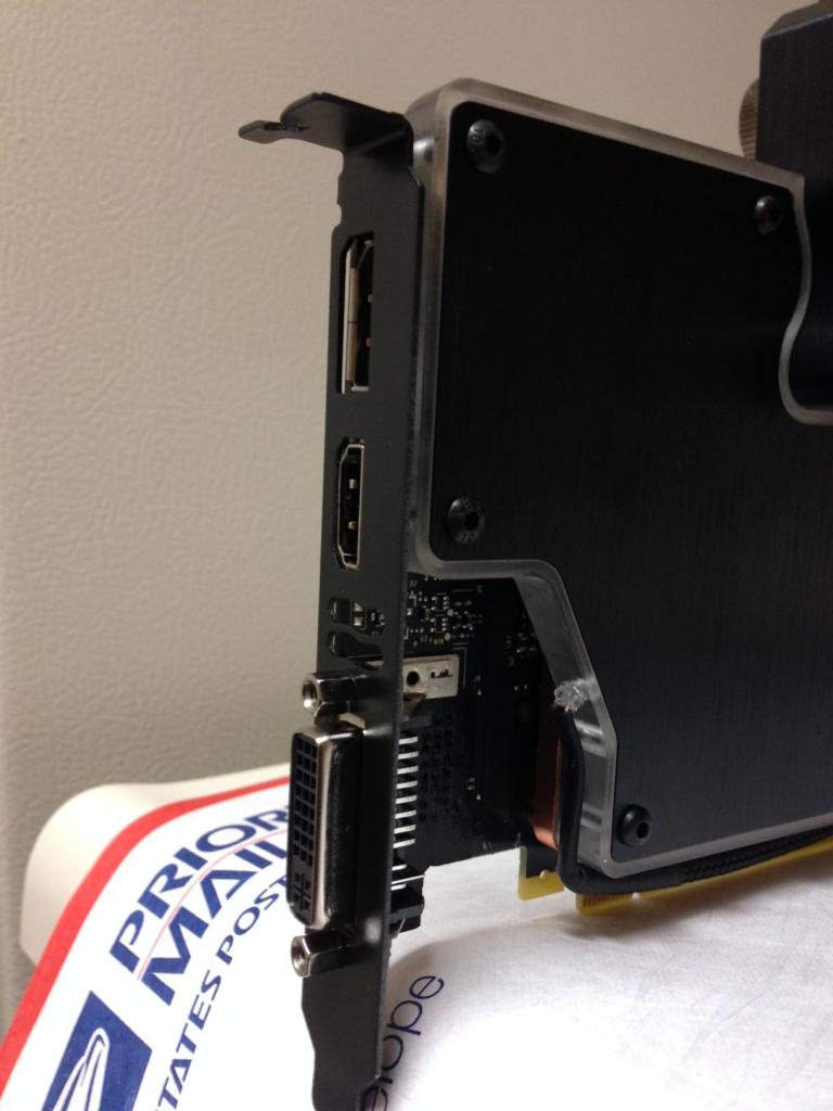

You can but you'll never want togueoct wrote:But once it´s done, you will never switch back to aircooling!
You are damned right! the gtx 780 Ti has the DVI connectors on top of each other.glimpse wrote:well, not exactly, You still need to do some hardware modding in order to get rid of brackets & operating out some connectors, that for some is scary to think of =DDDgueoct wrote:Most Air-cooled cards are dual slot, but with a watercooling they are 1 slot!smicha wrote: 780 ti are dual slot cards - you'll have to go with raisers for 6 of them.
On my Cards the sit side by side...which makes them single slot with watercooling

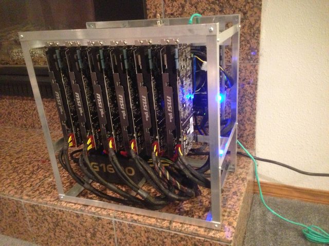

if You really looking to build 6+ GPU rig or even multiple of them,
miners are the way to look for inspiration:
or even bigger beast (concept by some Guy)
otherwise, modding & water-cooling is unavoidable,
but as Smicha noted - You can get more perfoance,
as water-cooling gives You some advantage.

And you can still water-cool it for less noise...glimpse wrote:p.s. if You really looking to build 6+ GPU rig or even multiple of them,

I've seen Guys modding Titans to SingleSlot, but You need to have balls for that.gueoct wrote:
Actually always wanted to build a monster on something like ASUS P6T7 or new ASUS X99-E WS
Stuffed with those modified into SingleSlot (Tatans/780s) - under water that beast should be insanely powerful..
..though I don't need that much of power for now nor have spare to build for fun =)
but would be more than happy to help someOne if needed =)
p.s. here's how SS modes Titan looks like:
