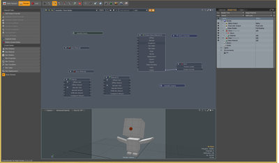

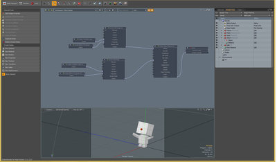

Here is the issue,
Modo has a nice way to save assemblies for later use, for example:
A character textured, rigged, can be then used with a double click into an new scene.
I tried this with a character that has octane material applied, but when imported the links get messed all up, and the material does not
come with the mesh, even when I check in the groups editor, the group related to the mesh contains all the elements needed for that object, like locators, octane nodes, but the links are broken.
My request, can you please take a look into this issue and see if the links can be perpetuated in the new scene for later use ?
Cheers,
Vlad
Could you pls send me the rigged character with the Modo materials?
I think if this is fixed, we can make material presets for modo, and this will be a huge workflow kick for me.
You can already create a preset for a single Octane material ("Save as Preset" button).
Paul

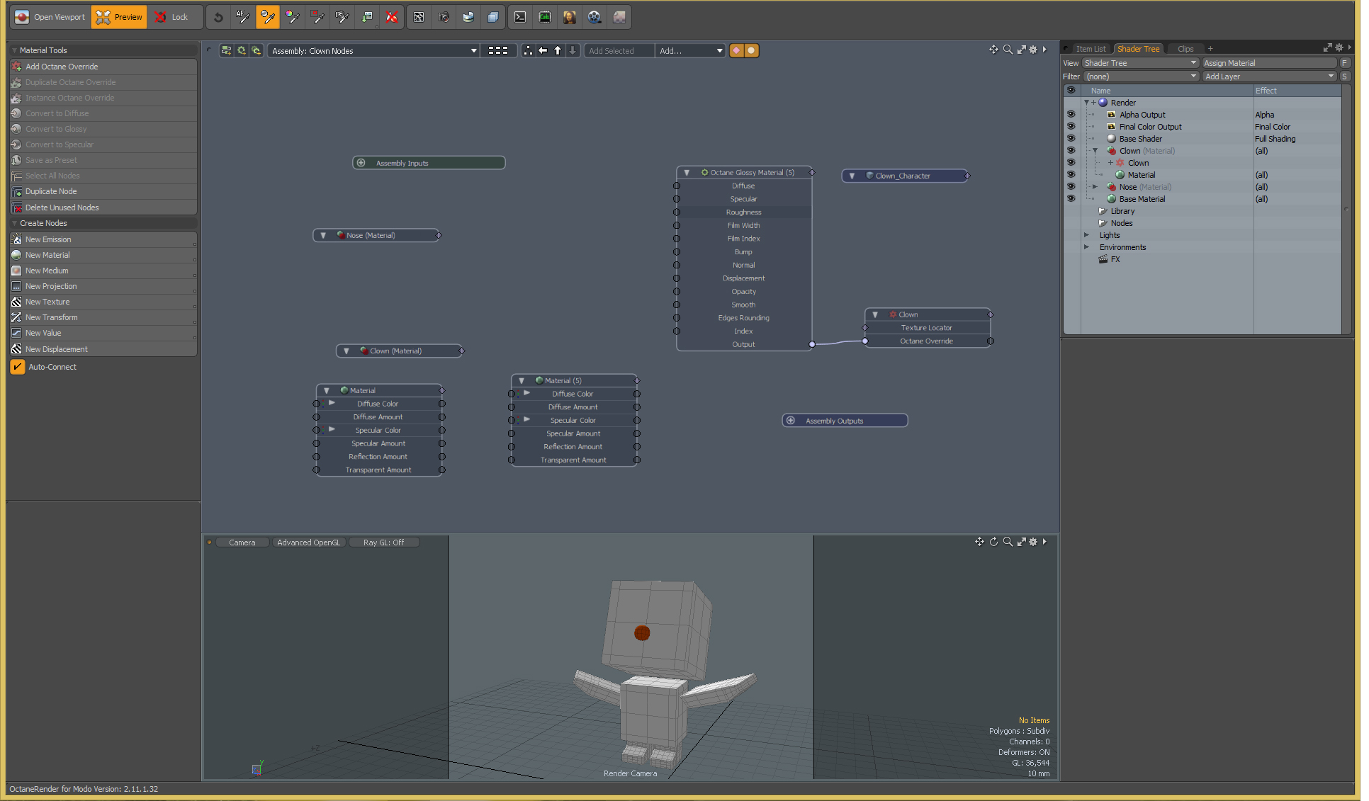

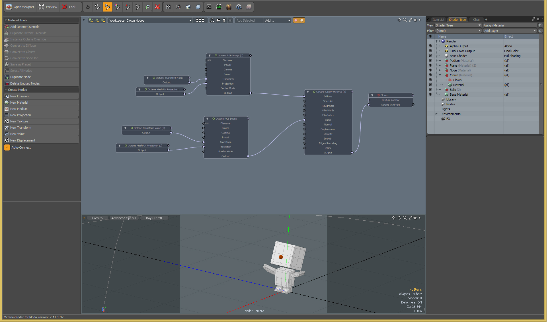

Hi Vlad - thanks for sending through the scene and additional info. Answering here in case others have the same question....
If you have a rigged character/figure, if you rightclick the Item and "Save Assembly", it will save the figure as an Assembly - but because each Octane Override for that figure is it's own Assembly, when you reload the saved Assembly, all the Octane Overrides will be in the one Assembly - and not work correctly.
Instead you need to save the figure as a Preset (although in the specific example you sent me, you need to merge the balls with the clown, or save the clown and balls as separate Presets).
Paul
