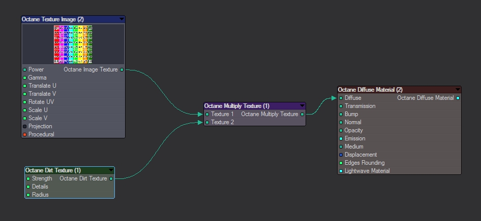

4# About the Dirt texture: I have a texture that I would like to add dirt to tight corners. If I add the Dirt node to the diffuse channel, I get the dirt to the corners but the texture otherwise turns washed out. How to just add dirt to the corners but not to affect the texture otherwise?

About the dirt node, perhaps you could use it with the texture multiply texture node to mix the main diffuse texture and the dirt effect, as you can see in the attached image. Also you can play with the "strength" parameter to make the dirt less visible.
