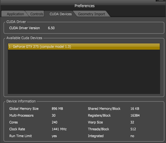

same problem
I have CUDA device, Nvidia card:
But no CUDA GPU?
no CUDA GPU.jpg (6.31 KiB) Viewed 4673 times
