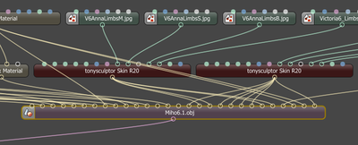

I just used the "Tonysculptor Skin R20". I am getting really good results but you still need to tweak it. The way I am using it is I connect the "Tonysculptor Skin R20" to the imported object and then attach the texture / bump as needed to it. I am attaching a partial screen shot to show how I have it connected.
When I started with it today, I was doing it all wrong and had it connected to a mixed material node with one side connected to the"Tonysculptor Skin R20" and the other to the texture. The result was pretty bad. Finally figured out that you need to connect the texture to the "Tonysculptor Skin R20" and it to the object and immediately it made a huge difference.
Hope this helps if you haven't already figured it out. Just playing with the standalone version until the Daz plugin gets fixed.

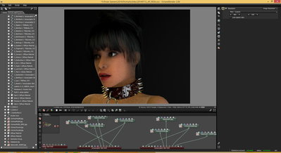

Thank you... but for me even that doesn't work.
I've tried several textures/bums/speculars/normals, using exactly the cofiguration shown in your sceenshots but even then I get horrible results (see attached screenshot)
There are big dark areas on some areas of the body. And I just don't know why the skin-shaders work for you and not for me...
See? The neck and the head-area (back of her head) are very dark (I didn't apply the shader to the limbs)

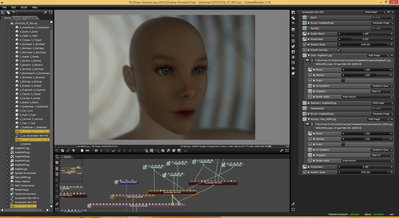

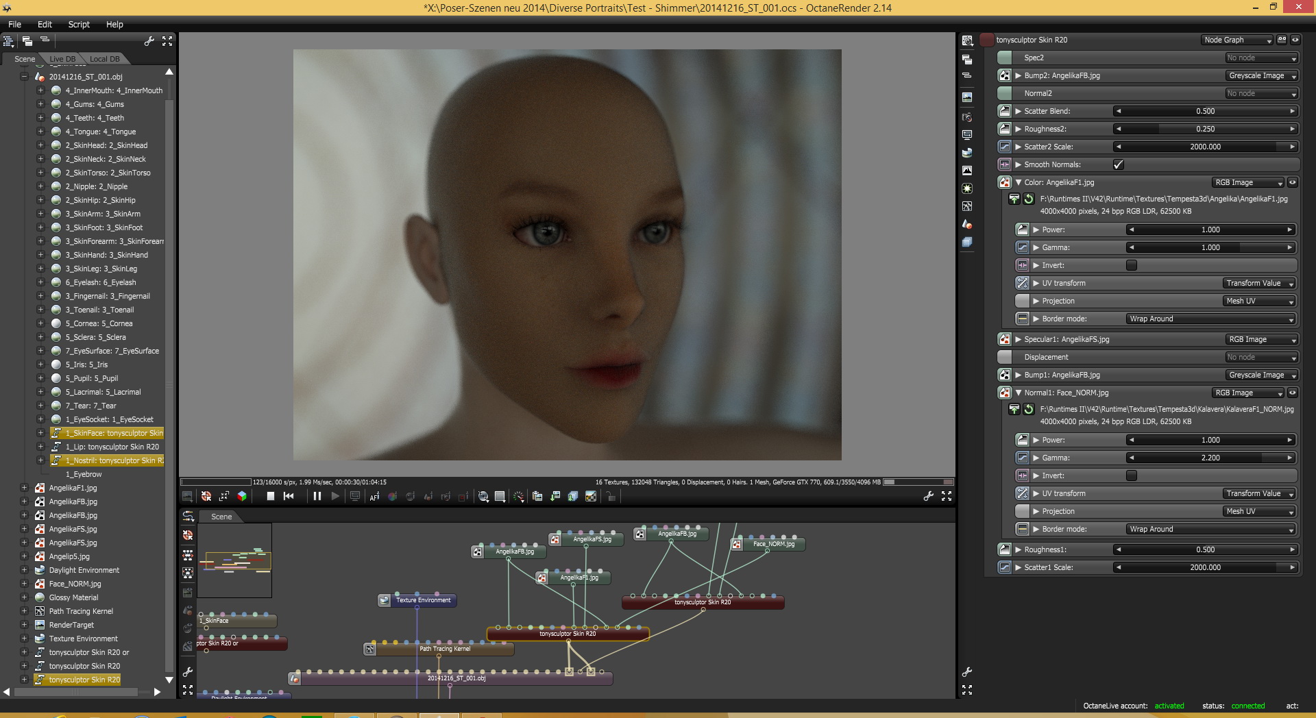

ppphhhhh.... I tried this for WEEKS now. Kernel is set to PMC or PT, but I still get very ugly results. Looks like wax or something but not like skin.
It's getting a little bit better if I try to set the SCATTER SCALE I to 4.000 an II to 1.000. But I'll have to lower the gamma of the skin-texture from 2.2 to 1.0. After all I have NO IDEA why this doesn't work for me because I did EVERYTHING exactly as you showed in the screenshots.
I would be happy if anyone could help me with that.
