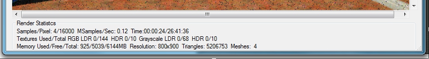

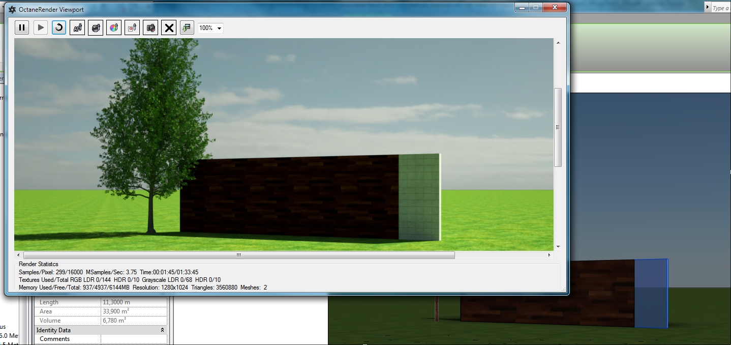

For me this is being correctly displayed. The number of texturemaps is in the "Textures Used/Total" line of the Viewport. If this is not working for you, could you pls post a screenshot of the Viewport statistics?
Screenshot on attachment.

Render statistics never display textures used (viewport window);
For the screennshot provided - where there actually any texturemaps used in the scene? Texturemaps will only be used if there is geometry in the scene with material assigned which have Image, Alpha Image and Grayscale Image nodes. Also, have you check the Log on the Devices tab? There might be texturemaps not found.

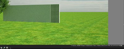

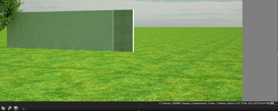

Another screenshot on attachment. Also, the shadows are in the wrong direction, even with Environment as daylight. There are no errors on the Octane log.
Are you setting the daylight up as instructed in the manual? http://render.otoy.com/manuals/Revit/?page_id=74
Regarding the texturemap numbers, if you export that scene to Octane Standalone (via OCS), what does Octane Standalone report your texturemap usage as?

Hi Paul, the previous image on attachment is from standalone - there, the texturemap usage is okay (same scene exported from revit). The gtx driver version is 9.18.13.3788 (337.88).
Thanks - I thought maybe the Nvidia driver version was reporting the wrong texturemap usage - but looks like it's fine. I have no explanation as to why the plugin is showing 0 texturemaps used. It's working OK for me - sorry.
