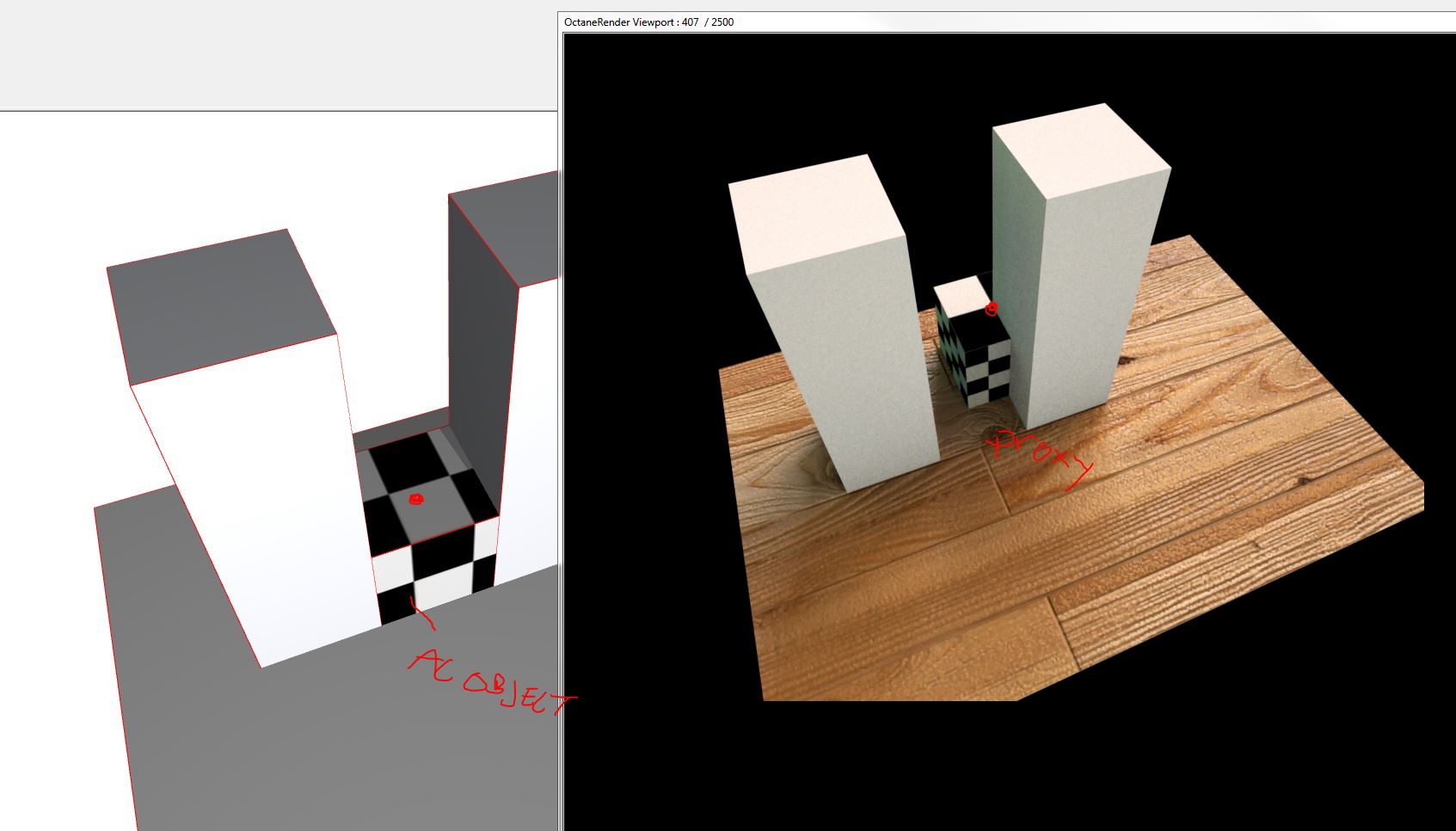

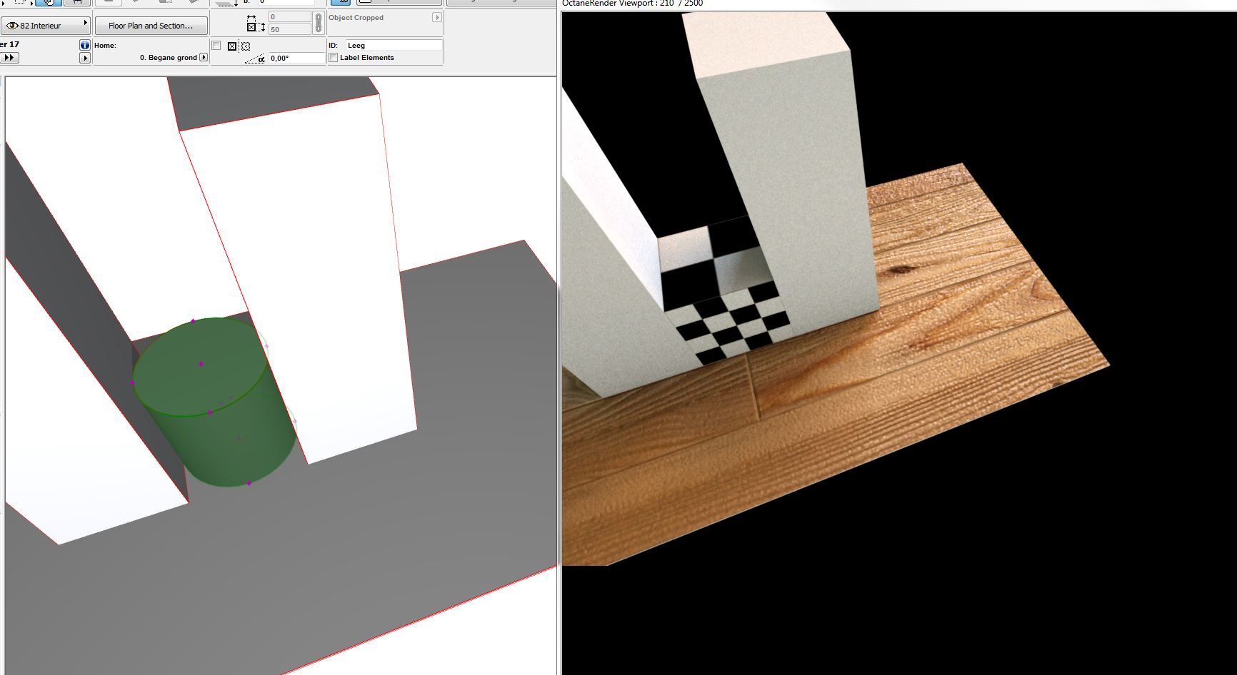

Hi Paul,
I noticed when using a cube or other Archicad object for assignig proxies makes a difference.
The cube seems not to assign the origin in the cneter (even when the Arhcicad anchor of the cube is in the middle).
When using a cilinder it is OK.
I always use a Cilinder, but now I encountered teh problem with using a cube and I remembered why I use a Cilinder and just wanted to let know.

face_off
Posts: 15830
Location: Adelaide, Australia
Hi Jeroen - I suspect the cube may have some sort of offset being applied that the plugin is not taking into account. If you send me the scene with the cube, I can take a closer look.
Paul
