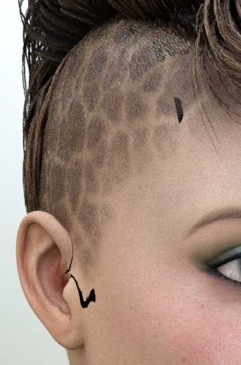

Setting 'rayepsilon' to 0.000001 previously would get rid of the black interference marks made by the likes of hair scalps too close to the head... but now this doesn't fix the problem. Is there a new setting for this or should 'rayepsilon be set to somewhere in between 0.0 and 0.000000000000000000000000000000000000000001 ?
Have you tried a ray epsilon of 0? Does the same scene in Octane 1.5 show or not show those artifacts at a ray epsilon of 0.00001? The correct workflow is to have the hair scalp not intersect with the figure's head in this case.

Duh... first thing was to use 0.0 ... Nope... 1.5 worked fine... check the forums for that version... you and I Paul have had this discussion before... it was you who suggested then that 'ray' should be set to 0.00001... and yes... you are right... a good idea as a workflow not to have the hair intersected with the head.
If this is an issue you want Otoy to investigate, install the latest 1.5 version of the plugin, open the Viewport (of the above head portrait scene showing the artifacts), save to ORBX. Then install the 2.0 plugin and do the same. Send both scenes to [email protected] with a summary of the issue (ie. artifacts showing in 2.0 but not 1.5), and then Otoy can investigate why ray epsilon at 0 is not working on 2.0 as it does with 1.5.
