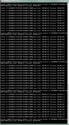

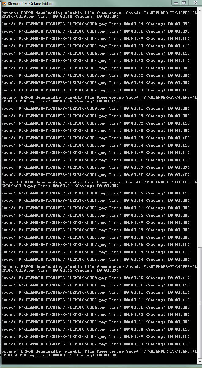

Well, It is scene dependent ! Kavorka is right, there is something I/we did wrong :!:
I made a new scene from scratch, as my scenes were very heavy. At my surprise, this time it worked in any configuration, and kept the right materials names in alembic. I tried many combinations with Full/Movable/reshapable, As is... every time with succes. However, I still get an error message at the end.
I also noticed that the alembic node keeps the material when I relink an edited geometry. It deleted every materials in previous attempts !
:arrow: I finally understood : duplicated materials with long weird names come from some materials with Blender nodes assigned instead of Octane nodes ! I didn't thought checking that in the compositor, because I was quite sure that this had an importance only for rendering Inside Blender. As I set up all my materials in Standalone and also because Alembic file doesn't export materials, I didn't thought that material nodes had to be assigned anyway before export ! It was not obvious.
The previous scenes I sent to you surely contained materials with Blender nodes assigned as well.
Despite the remaining error message at the end of export (export seems to be good), the export is finally correct. The bad side is that I have dozens of nodes to check/assign in Blender ! :roll:
Below the Console with successful export, but with the error message.
I send you the Zipped Blend file in PM.
