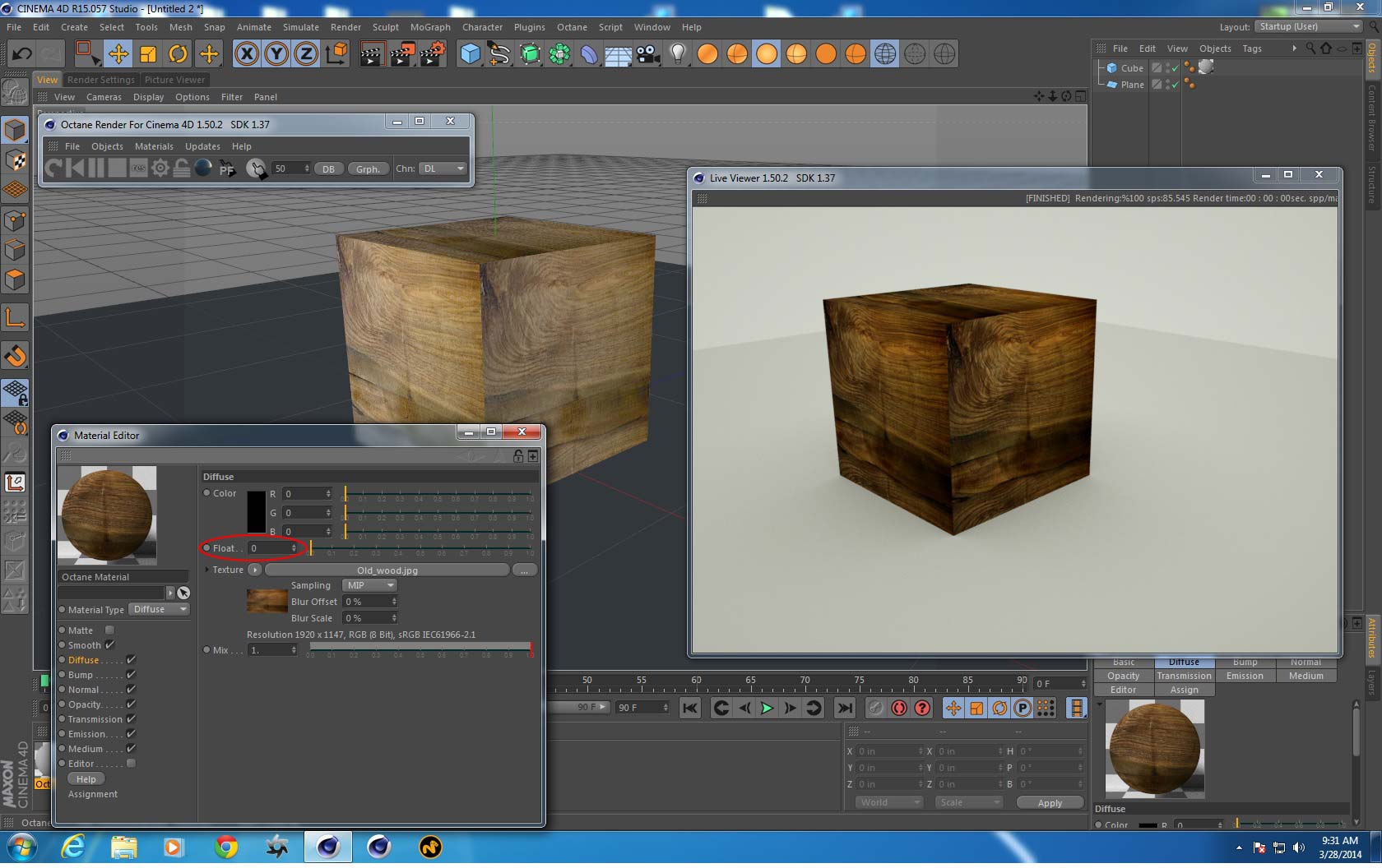

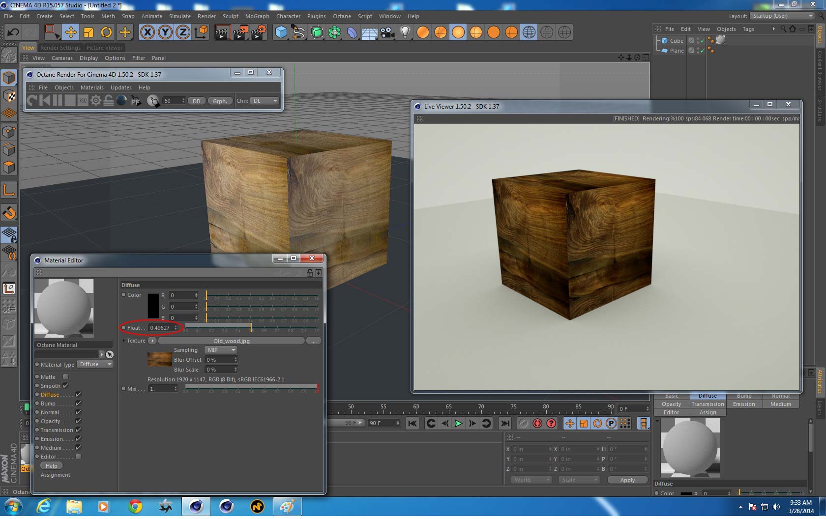

Little update on the texture preview issue.
It seems that if I move the float slider, the preview will turn to light gray.
Then moving the float slider again will restore the correct preview.
i7 4930K_Asus_RampageIV-Extreme_64GB_3-Titan_NVIDIA-337.88_Win7-64

Just did three screen captures. Check out the float values.
Preview_1, texture shows
Preview_2, texture not showing
Preview_3, texture returns
Is there something wrong on my end?
Posts: 16068
Location: Türkiye
artdude,
this is expected behaviour: www.aoktar.com/diffuse-tweak.mp4
why you have setted to float 1.0? Float value only works when you have no colors and texture.
Here, i couldn't get same effect. But i see you are working on untitled scene with relative texture file. In this situation, octane cannot know where is the project folder. This may be your problem
