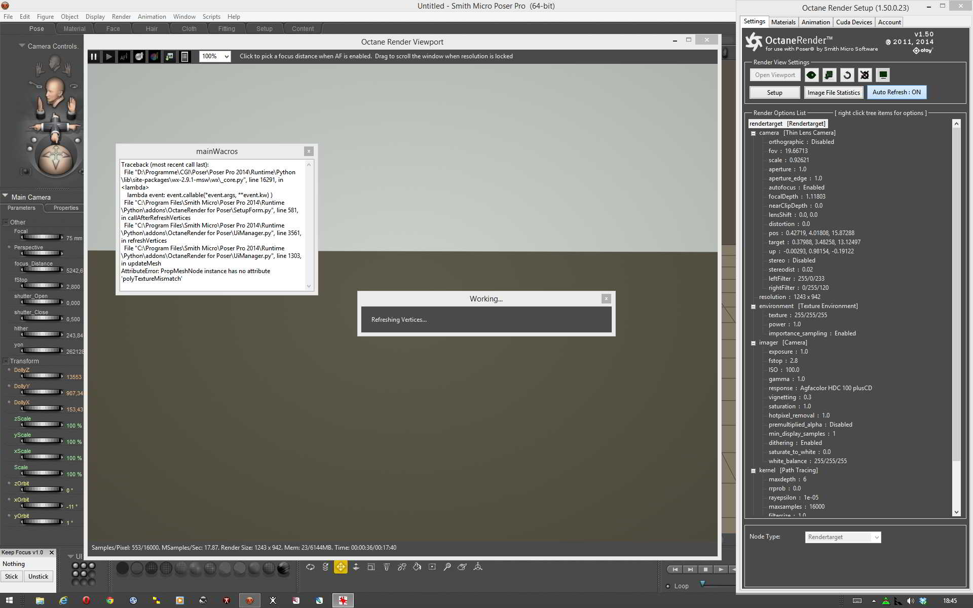

I have a default scene that is empty except for the ground plane and a (invisible) cube from the Poser primitives. That cube is for scaling reference and it's visibility is switched off because I only need it temporarily. It seems to me, that this causes the problem. If I load up Poser with my default scene and turn the visibility of the cube on, then everything works fine in the plugin. The error occurs when the cube is invisible.
Hope, that helps, if you need more info, just ask.

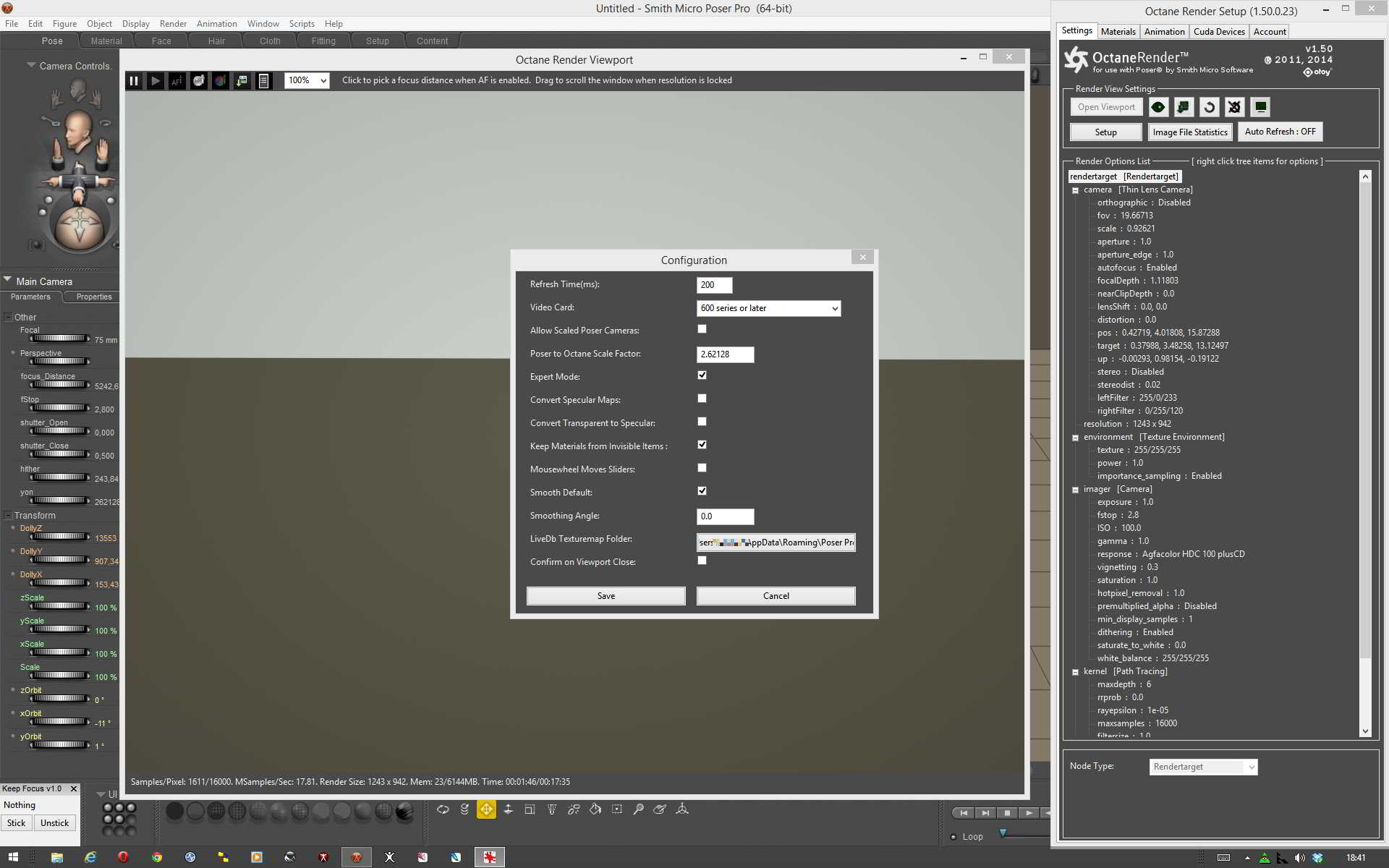

Uwe - if you could post a screenshot of your plugin Settings window - and post exact (ie. keystrokes/menu commands) for producing this error then I will have the best chance of replicating it and fixing it.
Paul

OK, here it goes:
1. I start Poser (nothing else, just with the default scene)
2. Render - OctaneRender
3. Settings - Open vieweport
4. Autorefresh ON
5 Message "Refreshing Vertices" and error message apears
6. Close the Plugin
7. Switch the cube to Visible
8. Repeat from 2 - no error.
Settings
Settings

OK, here it goes:
4. Autorefresh ON
Thanks Uwe. This is fixed in the next release.

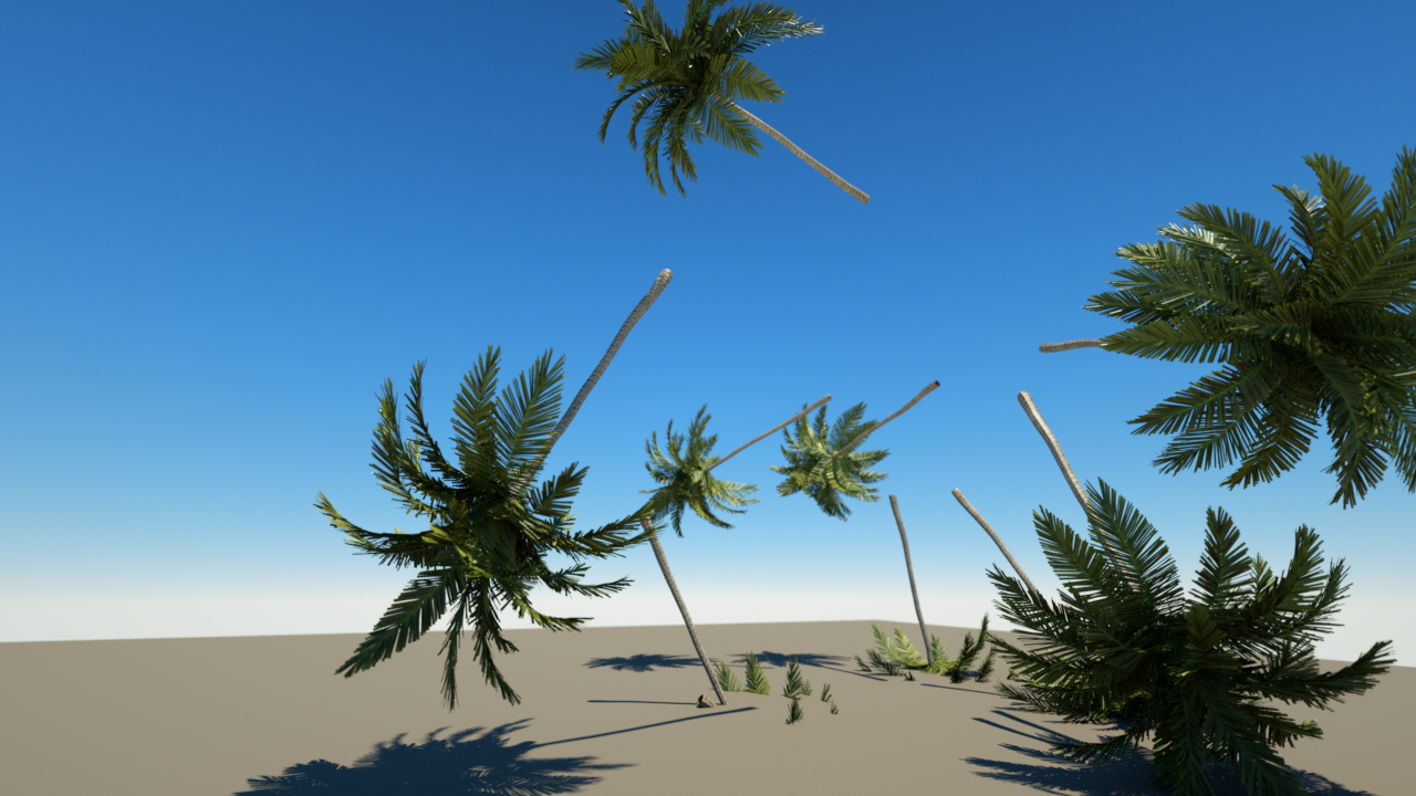

Hey,
I had to build a forest, so i was looking for instancing with Poser or the Octane plugin.
On your blog (Paul) I found the following topic.
http://poserphysics.blogspot.nl/2012/11/instancing.html
Following the instructions. I placed one palm tree in my poser scene.
Opened the Octane Render plugin window (1.50.22)
Setup my palm as a scatter instead of a mess
Generate a transform file
made it 10 total instances (with a 1000 it was a waver of trees)
After that add a 0.1 for position randomness (tried 0.01 too, even just 0.0)
No rotation and no Scale change...
I open the viewport and get... flying trees... so the scale, rotation and position values are ignored...
Included the render of my flyings tree.
Love the idea of instancing in octane.. but apparently it ignores the values for randomness (all zero still flying trees)
Xipomus
Posts: 21
Joined: Wed Feb 20, 2013 12:57 pm
Nvm i was placing the prop on it self... doh.

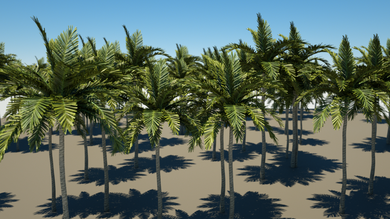

Need coffee or bed...
Included 100 trees.. works like a charm.. so anybody not know to this.. go play with it...
face_off
Posts: 15755
Location: Adelaide, Australia
Yes, you need to make sure the prop being scattered is at the scene origin (0, 0, 0). I will update the manual regarding this.
Paul
