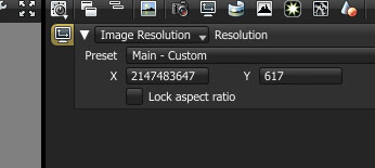

smicha
Posts: 3151
Location: Warsaw, Poland
abstrax wrote:
smicha wrote:
abstrax wrote:Please be aware that you can't render the maximum resolution with current hardware since the film buffer wouldn't fit into VRAM. In case you just want to increase the image resolution in one direction, the film buffer should fit, but you may have to switch to the software viewport since OpenGL may not be able to display such large images.[/color][/b][/list]
Marcus,
I tried to increase a very simple scene resolution. What I managed to achieve was something about 16000 x 600 (Titan). Then a blank gray screen appears and I cannot display a model in the preview window anymore and I must close Octane. See the screenshot. Is this OpenGL limitation or should it work under such resolutions?
That's the OpenGL limitation I mentioned. You can get around it using the software viewport (File -> Preferences -> Application -> Viewport).
Yes - switching to software settings solves it. IMO this should be the default settings. Is OpenGl settings superior in any cases?
Just a small bug: when I input '999999999999 in X resolution panel the number is changed to '2147483647' instead of 32768 - see the screenshot.
