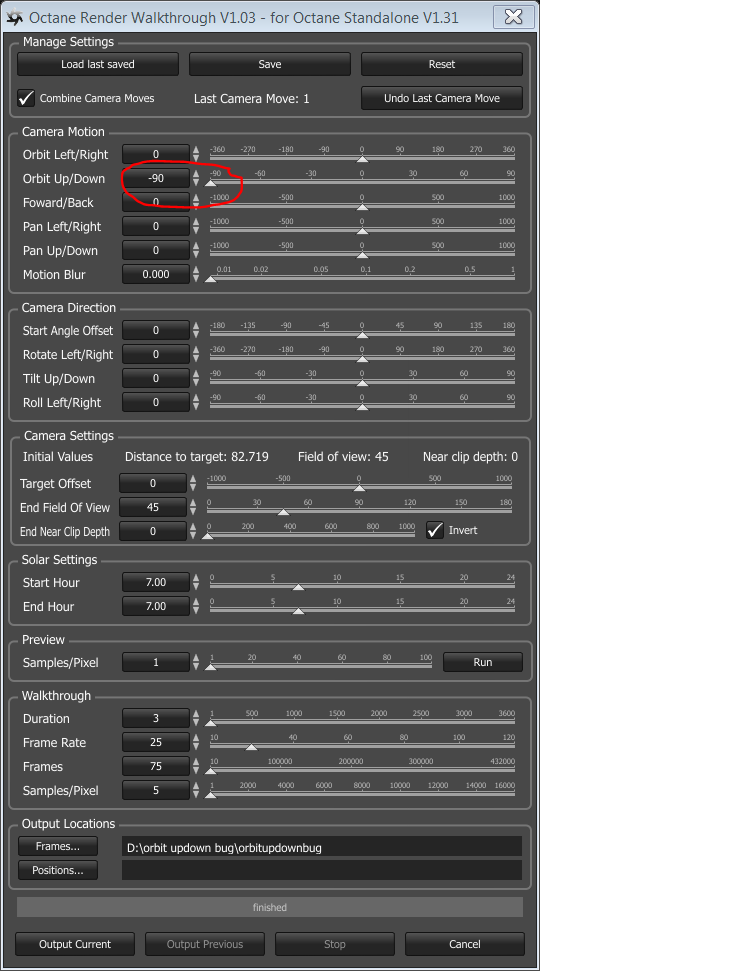

Thomas,
Here are my settings, and a video of what i see.
I'm wondering if it could be a rounding difference between your code and the script. I am trying to test if the view direction vector and the camera up vector are parallel. If you could write a test for that that worked inside an if statement i might be fine.
i believe there would be two valid tests, if the cross product of the camera up vector and the view direction = zero, or if the two vectors equalled on another.
Using print statements and examining numbers, they never actually equal each other, so the test is never passed, and the code never flips the camera direction, but the model flips as shown in the video never-the-less.
Point taken about daylight settings.
best
Mark

stratified
Posts: 945
Joined: Wed Aug 15, 2012 6:32 am
Hi Mark,
Now I understand what the issue is. Altough I don't think that your code actually flips the up vector, still it was a bit crude of me :oops:
I don't know what the exact behavior is you want when you go over the poles. IMHO it's the most natural if you gradually rotate the up vector along. That means that when you cross the pole, the scene is upside down. Like in this video:
[youtube]http://www.youtube.com/watch?v=eqY8auMUk98&feature=youtu.be[/youtube]
All you would need to do is modify your code to this:
Code: Select all
 	if blnOrbiting == true then
        	-- Calculate the horizontal angle of rotation for this frame relative to the original view direction
		local angHorizontalOrbitIncrement = math.rad( (ease(V)) * CamHorizontalRotAmount)
        	-- Calculate the vertical angle of rotation for this frame
		local angVerticalOrbitIncrement = math.rad( (ease(V)) * numCamOrbitUpDownAmount )
        	-- Rotate the viewing direction around the camera's up vector to orbit left or right
		vecCurrentViewDirection = octane.vec.rotate(vecInitialViewDirection, vecInitialCameraUp, angHorizontalOrbitIncrement)
		print(" vecCurrentViewDirection1",vecCurrentViewDirection[1],vecCurrentViewDirection[2],vecCurrentViewDirection[3])
		vecCurrentCameraRight   = octane.vec.cross(octane.vec.normalized(vecCurrentViewDirection), vecInitialCameraUp)
        -- Rotate the viewing direction around the camera's right vector to orbit up or down
        vecCurrentViewDirection = octane.vec.rotate(vecCurrentViewDirection, vecCurrentCameraRight , angVerticalOrbitIncrement)
        -- modify the camera up vector
        vecCurrentCameraUp = octane.vec.cross(octane.vec.normalized(vecCurrentCameraRight), vecCurrentViewDirection)
		print(" vecCurrentViewDirection2",vecCurrentViewDirection[1],vecCurrentViewDirection[2],vecCurrentViewDirection[3])
	end
BTW: you should configure your editor to convert tabs to 4 spaces. The indentation is all screwed up.
cheers,
Thomas
