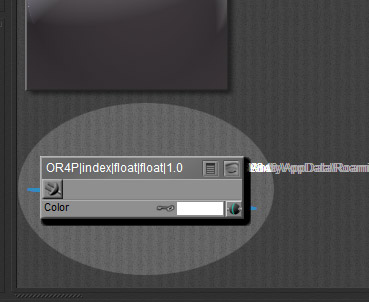

no error, but don't load the octane material applied to cube prop
maybe i don't understand how save and load the material create from octane into poser:
3) Poser Material Room, save Preview to the Material Library.
this is the material saved from octane plugin into poser
