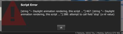

When closing the in-built Daylight Animation and Turntable scripts I am getting this 'stop' error, below.
