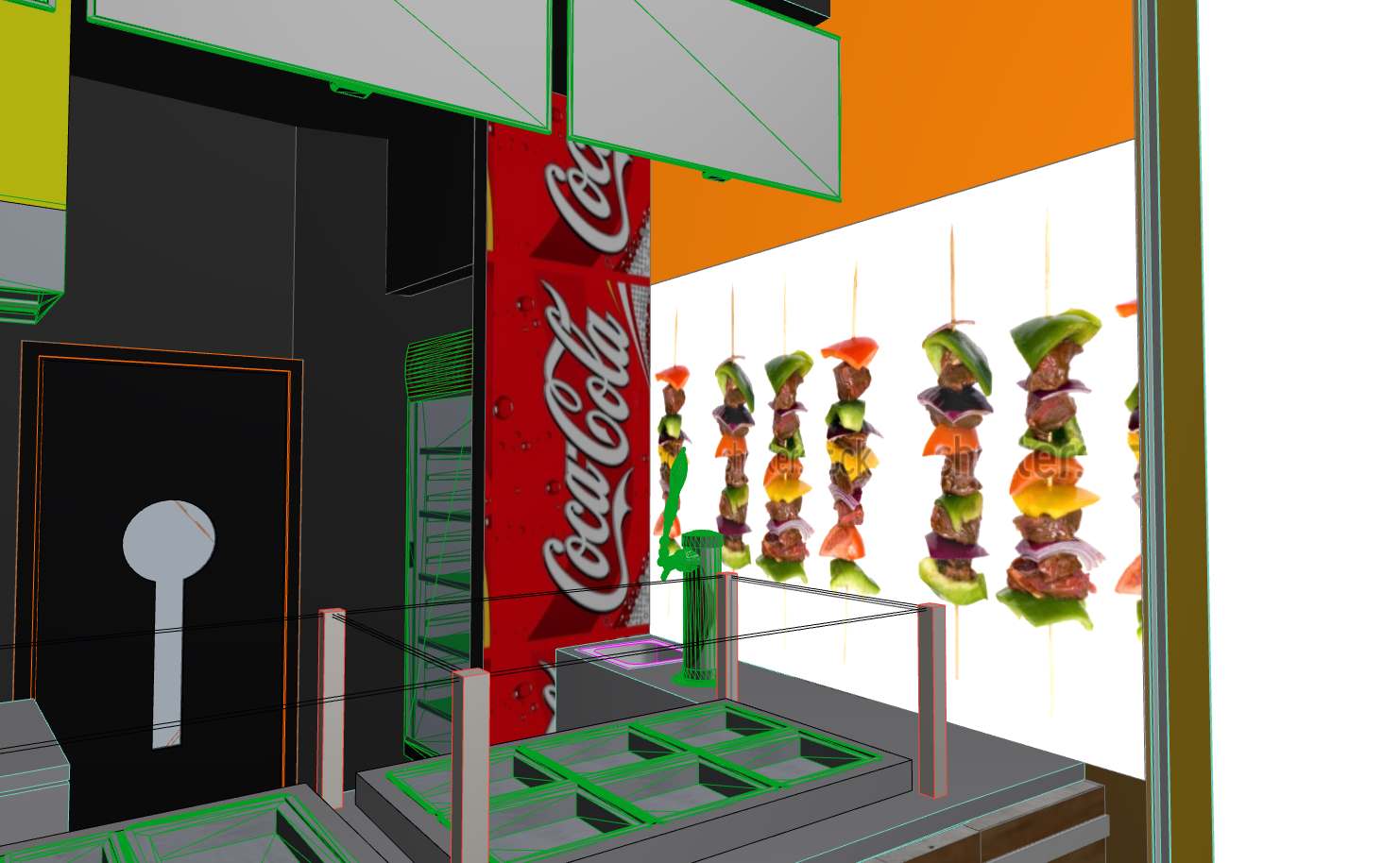

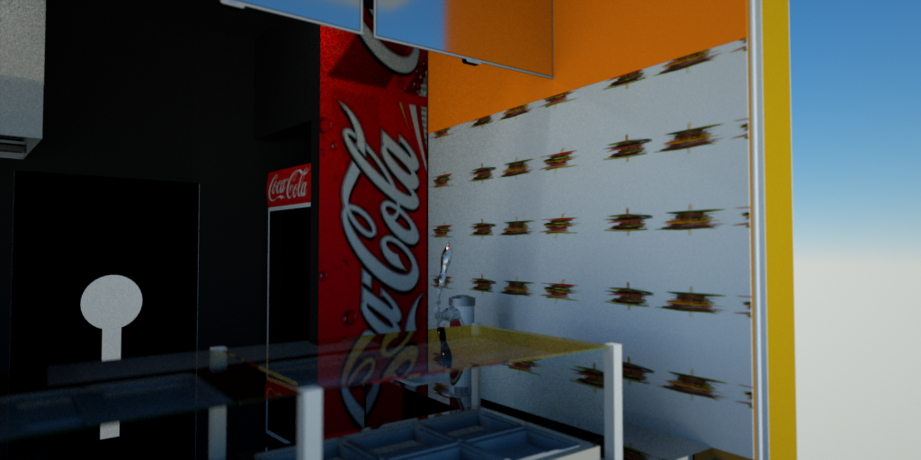

Anyway - my textures issues are exactly the same as BfPuVAK's and I am glad you will fix it soon. I made new file with 2 walls and a slab, and also got this errors:
octane 1.27 140128 155737.log
cuda log
(5.65 KiB) Downloaded 378 times
. Model looks like this ( showing the same error as BfPuVAK ):

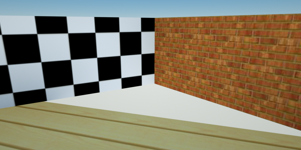

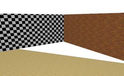

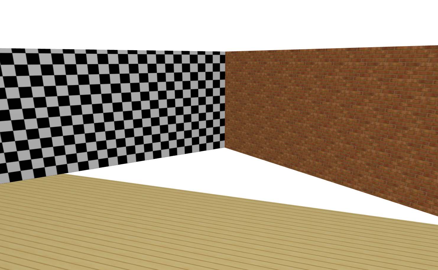

I also got sometimes a strange distorted and scaled textures ( when making my own archicad material ), I am not sure if it is the same reason:
archicad 3d
archicad 3d
octane 3d
octane 3d
