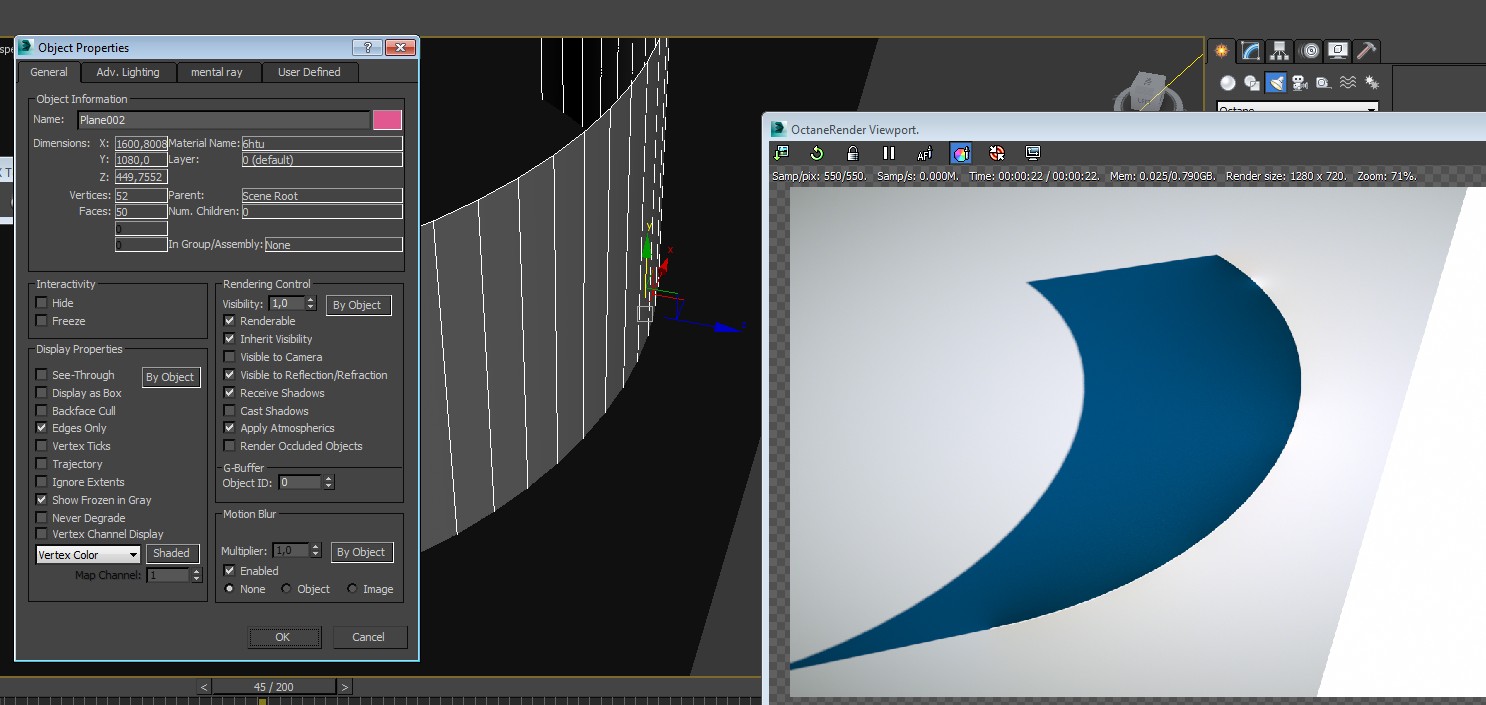

suvakas wrote:Could someone confirm if Cast shadows on/off is working properly?
It's not working for me.
Suv
Cast shadow option works only with emitters, direct sun light and environment light with image texture and importance_sampling enabled.

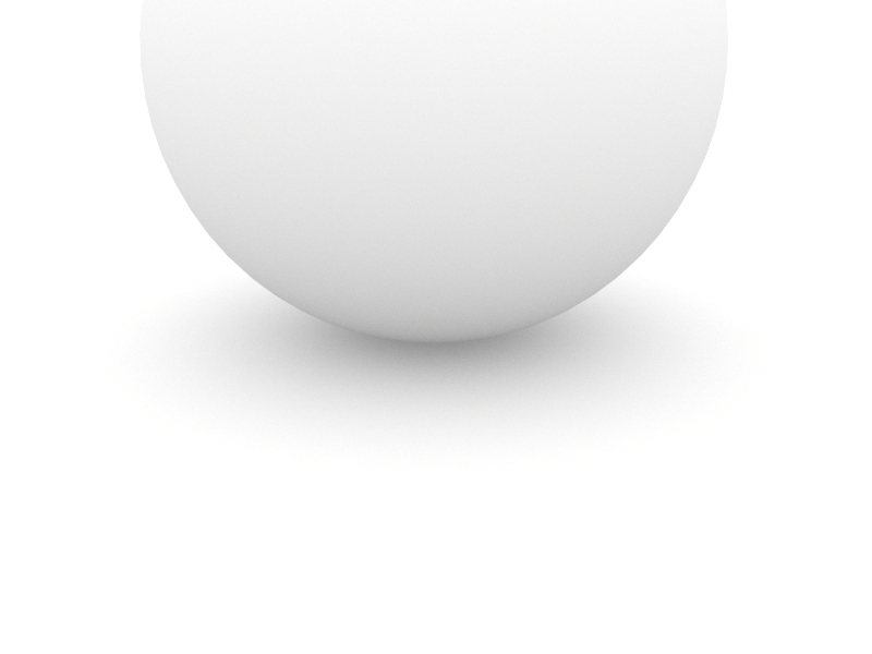

bicket
Posts: 365
Joined: Thu Mar 01, 2012 10:46 am
sorry
hdr is just a white plate
here is the result and the hdr file. What is it ? if not a shadow.
As far as I'm concerned, light should pass through an object that doesn't cast shadow.

bicket
Posts: 365
OK I just understand what you mean.
The darkest part is the true color of the material and the lightest part is du to light bounce.
I apologize. ;)

Karba wrote: Cast shadow option works only with emitters, direct sun light and environment light with image texture and importance_sampling enabled.
Thank you for the answer. I clearly stated in one of my postings, that it does not work with sunlight.
Here's the screenshot again in case you missed it on the previous page. I'm telling you, the feature is buggy in my workstation.
Suv
direct sunlight !!!
direct sunlight !!!
suvakas
Posts: 503
Joined: Sun Jun 12, 2011 10:26 am
I found out the problem - it's not working when the model is movable proxy. So there you go - that's the restriction.
Suv
Karba
Posts: 2300
suvakas wrote:I found out the problem - model can't be movable proxy. So there you go - that's the restriction.
Suv
That is a bug.
