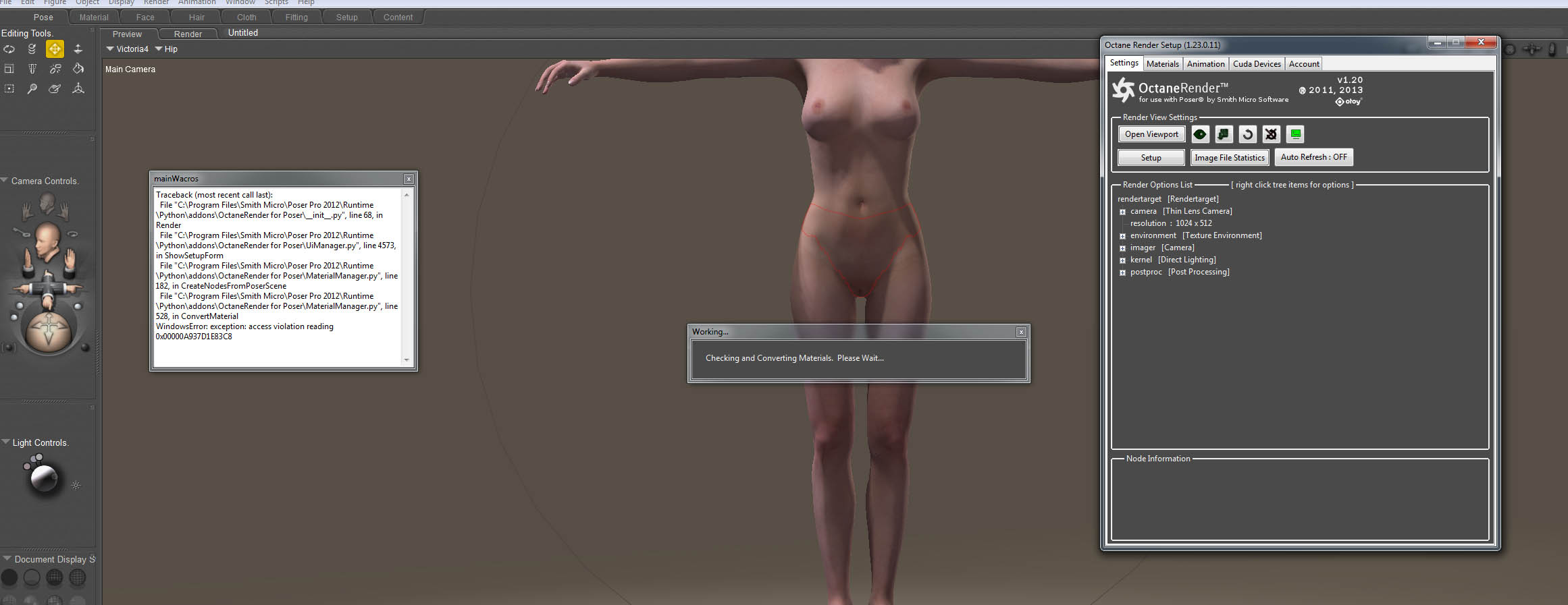

Just an update I've checked other vendors. And it looks like it does the same error. Take just about any vendor and skin V4.2 and the program will crash.

v4.2 is not the problem its seams it any base skin. that you put on top of v4.2 if that make sense
and default andy does not have any these errors.
Tnx. If you load V4.2, apply the standard mat pose, so she has the base texturemaps applied, run the plugin, then reconvert the body material - does the error occur? If not, if you then apply a 3rd party MAT pose, then reconvert the body material, does the error occur?

1 Workflow load v4.2
2 load base skin
3 open octane render r
4 watch it crash
part 2 workflow
1 load v4.2
2 open octane render
3 load base skin
4 Reconvert materials from this prop/ figure from poser
5 watch poser crash :cry:
2 load base skin
3 open octaine render
4 watch it crash
That works fine for me. There must be a difference between our configurations which is causing this.
Could you pls try deleting OctaneDefaults.py (make a backup first), then reinstall the plugin and try again?
Also try deleting Config.xml (in C:\Users\[username]\AppData\Roaming\Poser Pro\10
If that doesn't work, could you save the scene after step 2, before step 3 and send it to me, or even better - if you have it, use scene collector. Either email it to me if < 5Meg, or I can provide a Google Drive update location for you.
Paul

If you UNTICK "Convert Specular Maps", does that help?

deleted every thing in C:\Users\[username]\AppData\Roaming\Poser Pro\10
reinstalled
same happens

I have found an issue where if you have "Convert Specular Maps" ticked in the Setup, there is an issue creating the nodes. I will post a new version shortly - not sure how many of the issue it will fix - but it's a step forward :-)
