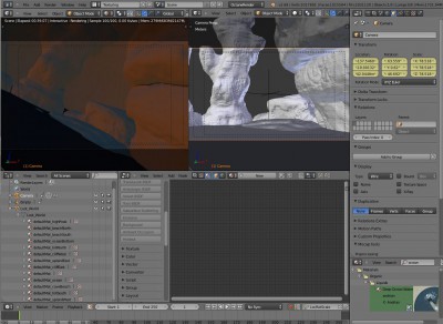

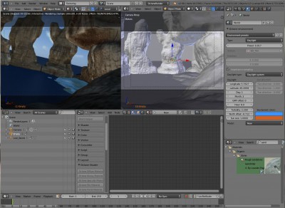

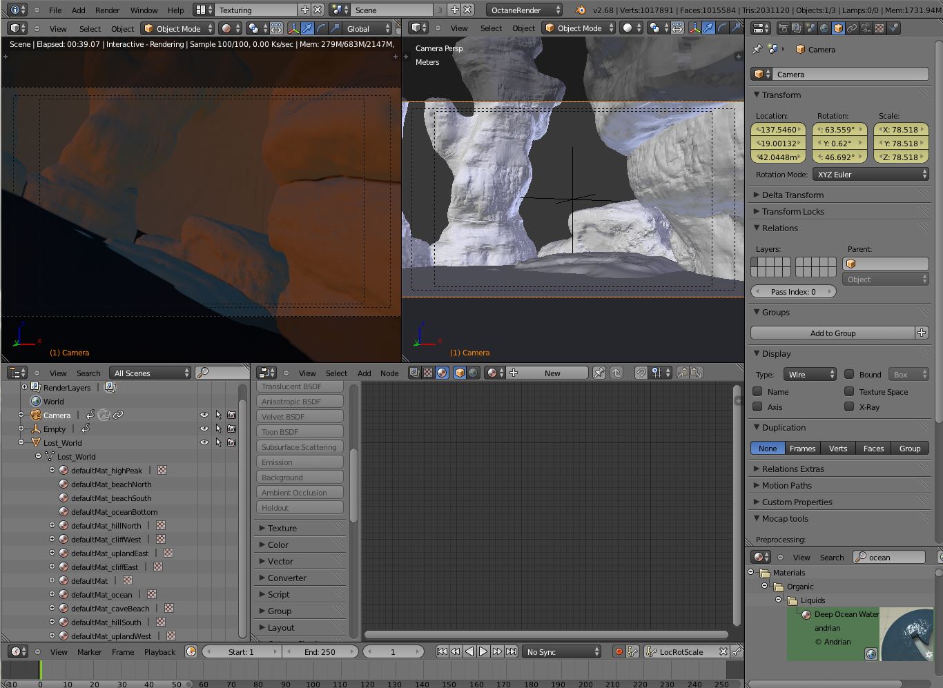

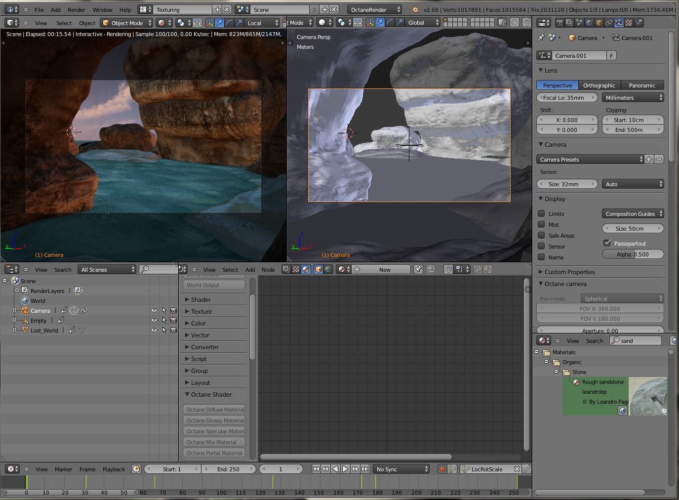

This is the only project it has happened in (so far) but am currently having a rotation issue with the render view not matching the camera view! I am looking in to it right now but thought it worth seeing if anyone else has had this problem? Due to the Cam being tracked to constraint (empty)?
Thanks ;)
PS: Jimstar.. I am REALLY impressed with your work on this mate :D
[youtube]http://www.youtube.com/watch?v=2Km5kJkWm6M&feature=youtu.be[/youtube]
Only render window effected ! viewport cam stays with correct alignment BUT when moving cam or empty the render view ONLY (!!!) goes out of alignment!
Cams not matching render window!
Messing with Axis/empty location...

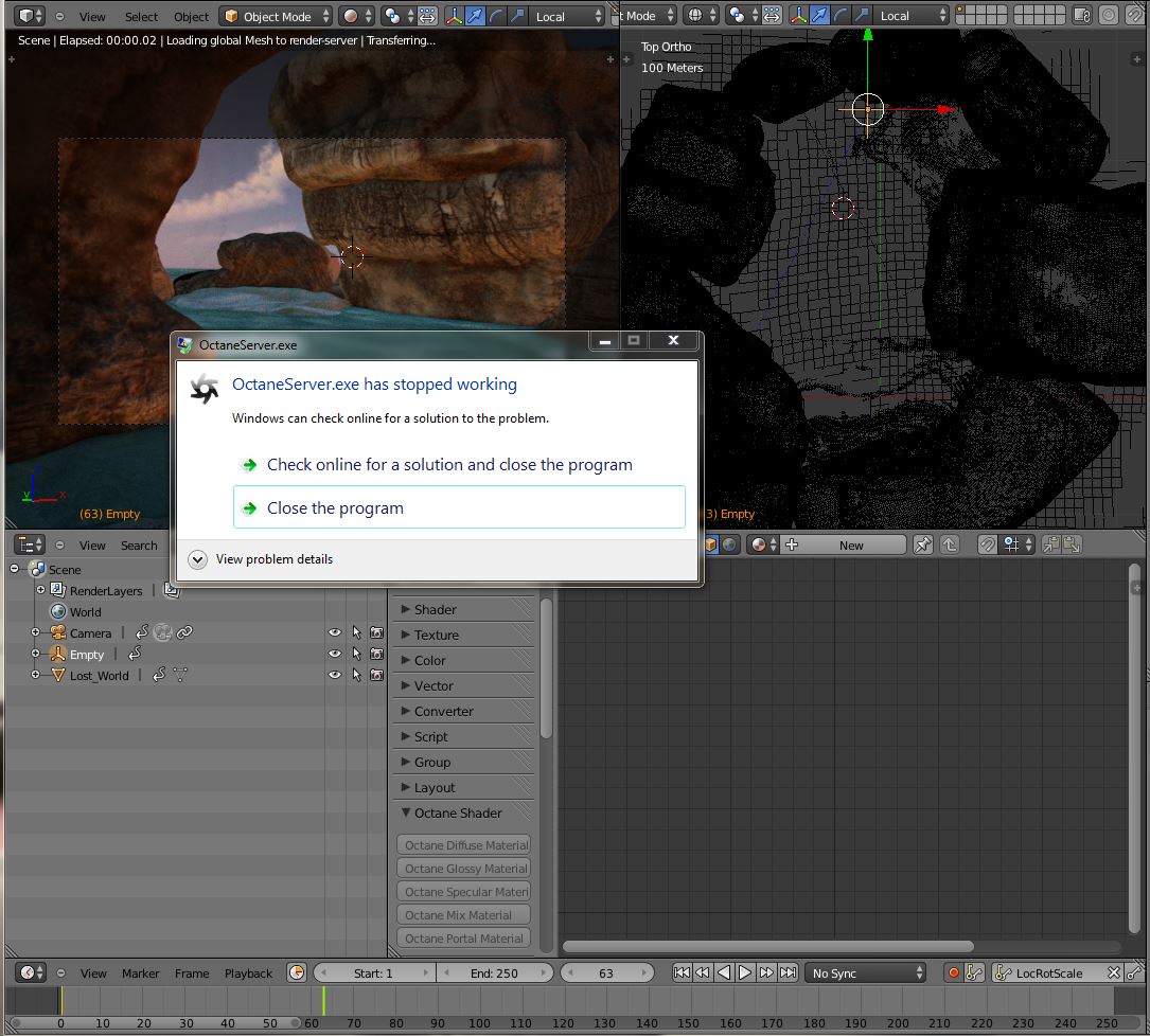

Server crash!
Server crash!
Well, apart from server crash (not sure about that!, you need a server log?)  I am not sure what to do, if it was user error then surely both cam view and render view would have the same alignment error Right?

For "live-view" rendering mode you should compare the camera of the same viewport window, not the different windows. As you have absolutely different size and aspect ratio of different opened viewports (or camera and opened live-viewport), and the Octane's "live-mode" recalculates the camera's view-angle to fit in the current viewport size and aspect...
So, the right way to be sure that it is the bug or not - to compare it in the same view, enabling-disabling the live mode and looking at congruence of the Blender-viewport image and the image rendered into the same viewport by Octane...
Or render in the "F12" mode and compare this rendered image to Blender's camera view...

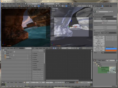

UPDATE/edit..
I am currently running a short anim sequence over night (250 frames @ 100 samples, like i say..need sleep!) and have noticed off the bat that the generated frames are indeed showing the unwanted 'tilt' that does not show up in camera view but does in 'live mode' & final render!
will upload the rendered anim to youtube & post here tomorrow, along with more in depth test results after following your advice in more detail :) and getting some sleep of course :roll:

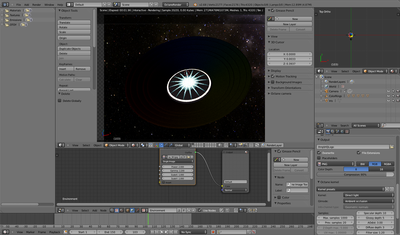

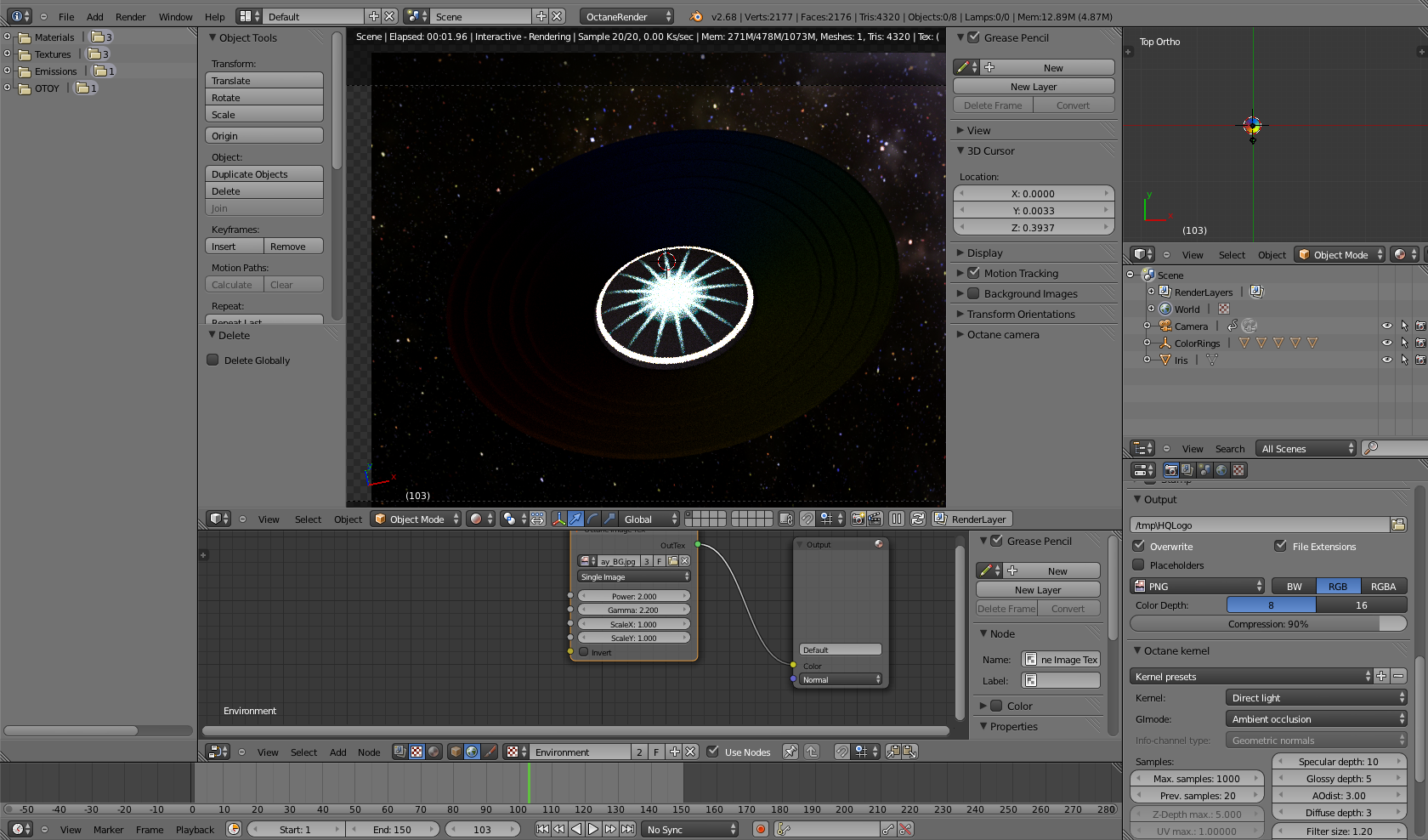

Hi!
Could someone help me please?
I try to make somethinge glow through glass.
The environment is the space.
This means everything is dark and the glow comes from a texture.
But through the glass its just dark.
I need to render it with direct lighting, because my hardware is not th fastest ;).
I packed a rar with all needed files. Please take a look :)
GlowGlass.rar
Texture-Emitter through glass in a dark environment.
(468.87 KiB) Downloaded 298 times
WIN7 64bit • 32GB DDR5 RAM • Intel i7 6x4GHz • GeForce GTX780 • Blender

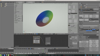

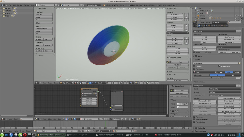

mib2berlin wrote:Hi dafassi, are these the correct files?
I see a Iris with rainbow colors.
Cheers, mib.
Hi Mib,
without glass it should look like the attached image!
