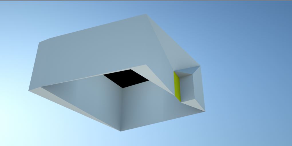

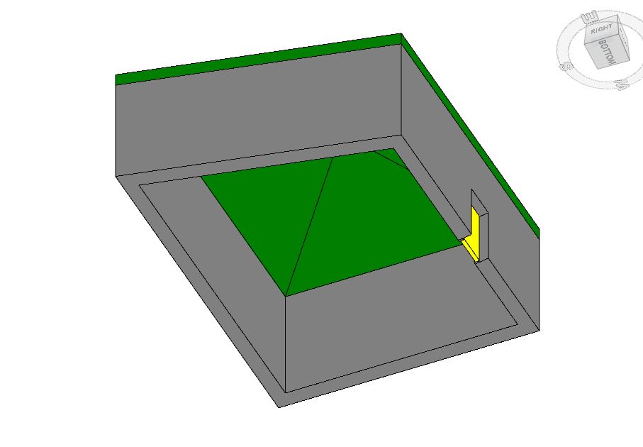

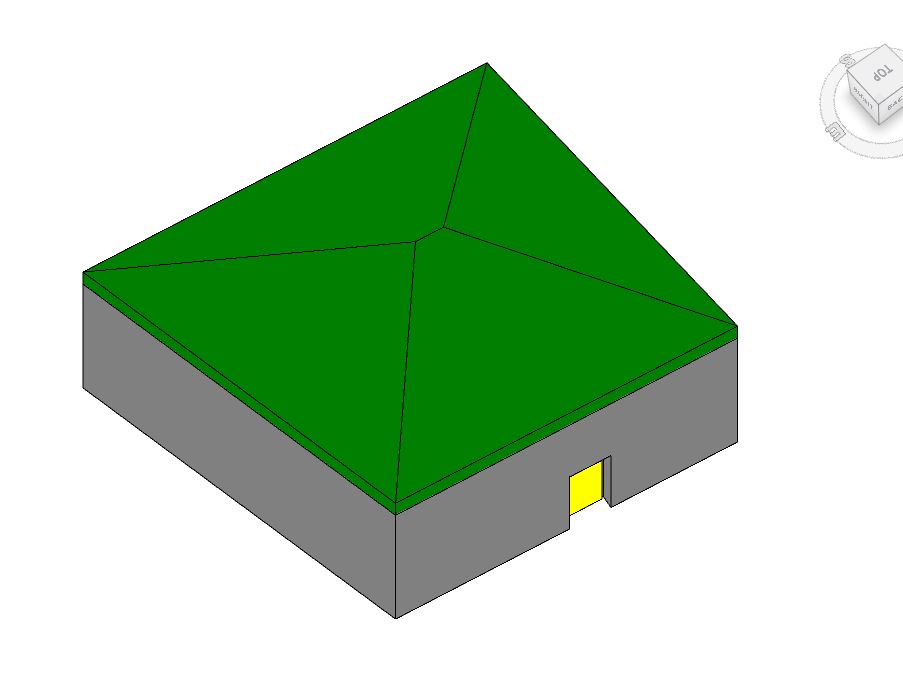

Hi Clive
I just did a quick test.
As you can see, I have some issues trying to export this very simple building.
I use Revit 2014.
I don't expect you to provide support - I'll just let you know.

Are you viewing the OBJ in 3DS MAX (Design)?
The OBJ files are too simple at the moment for 3DS MAX (Design). How does it look in Octane Render?

Agrh sorry Clive, I should have pointed it out.
The render is frome the standalone version of octane. the two others are from inside Revit 2014.
Jorgensen
