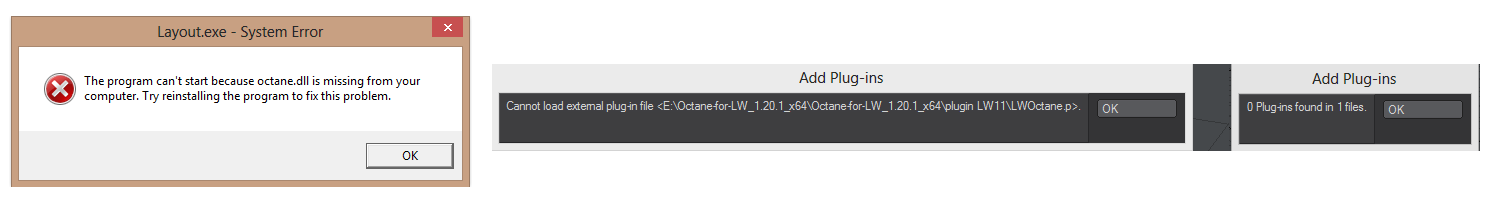

renderlight
Posts: 30
Joined: Fri Dec 23, 2011 4:19 am
I only have x64 version installed of all software. My Octane standalone works fine.
My dates don't match yours, but that is the most resent that I could download from Otoy.
I also deleted Octane.dll and Octane.dat file from LW bin folder and got that the Octane.dll is
missing, but when I close that error. The original error returns. Also when LW is close and
restarted it act like the plugin has been added and gives the Octane.dll missing error before
LW really starts.
Octane Render10.png (3.91 KiB) Viewed 4668 times

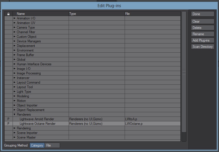

And what happens if now you add the Octane.dll and Octane.dat files to your LW/bin? ... if LW show this error could be because it has the plugin installed, at least some of it's internal plugins ...
You can check in the plugins manager window if plugin is available, you should have one line with Octane renderer like the one highlighted in this screen grab.

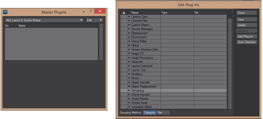

Can you also please check if you have any plugin running inside your Masters plugin window (CTRL+Q to open the window).
-Juanjo
renderlight
Posts: 30
Adding files back in LW/bin brings back original error.
There no plugin running inside your Masters plugin window.
There are no plugins like the one highlighted in your plugins manager window.
