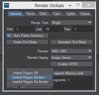

Any help on how to use 'render region'? Cant figure it out

gordonrobb wrote:Any help on how to use 'render region'? Cant figure it out
It should work like the native LW render region. You can also use the "l" hot key to enable it.

I knew how to use the limited region, just couln't get it to work with Octane, but then I just realised it only works with F9. Any way of it working with the IPR?

gordonrobb wrote:I knew how to use the limited region, just couln't get it to work with Octane, but then I just realised it only works with F9. Any way of it working with the IPR?
No, sorry ... currently limited region only works for final render.
