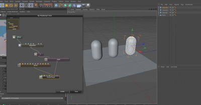

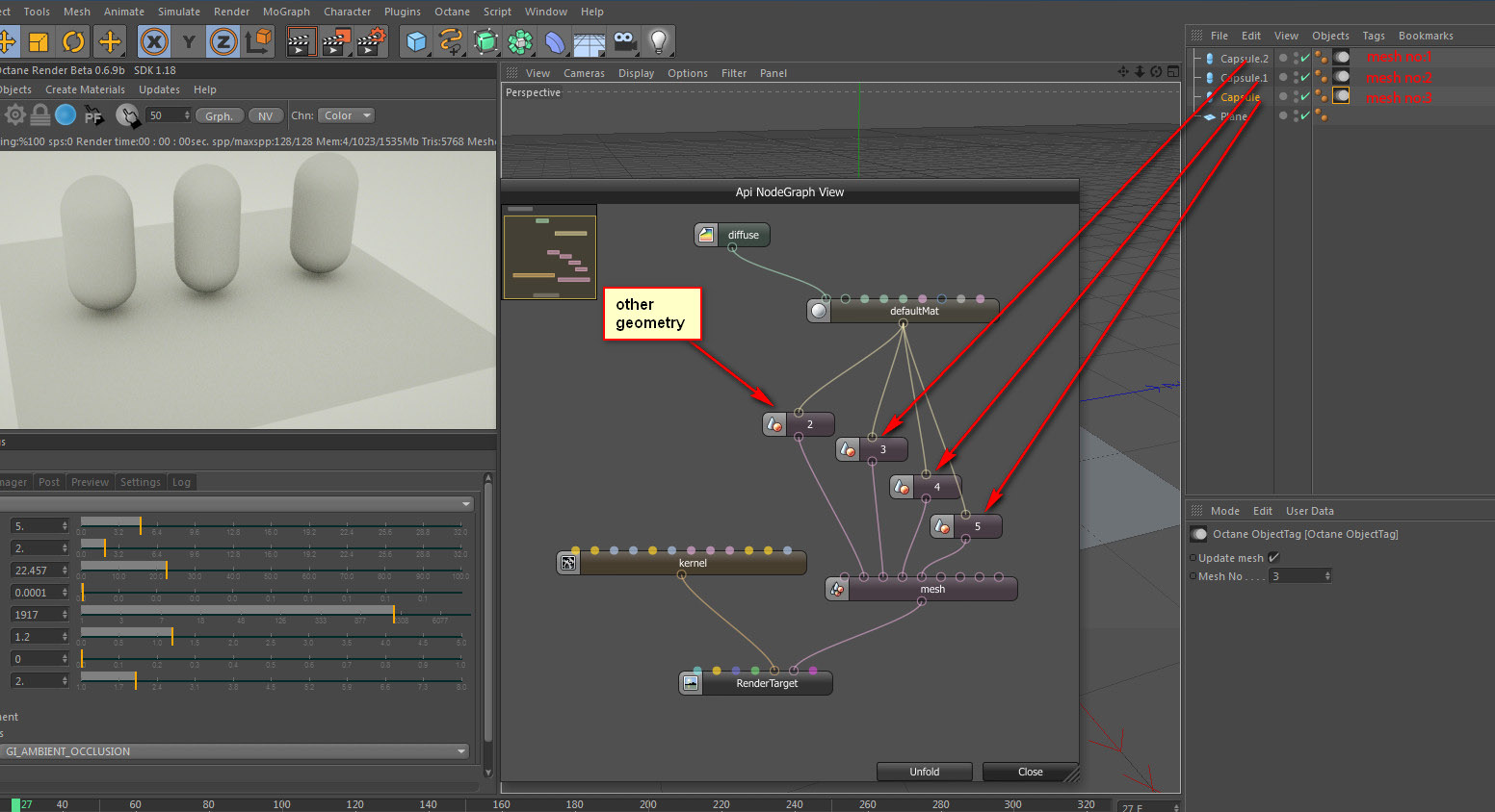

i want to make more comprehensible the processing of export process. Until it's replaced with more clever algoritm, it's like that.
If we look two images, in first image, every geomtery is collected under a octane mesh. But in second scene, you'll see every capsule object assigned different geometries. Buffering of geometry is done seperated arrays and free after each proces. Because of this, peak memory usage will be lower than collecting all meshes to one geometry.
