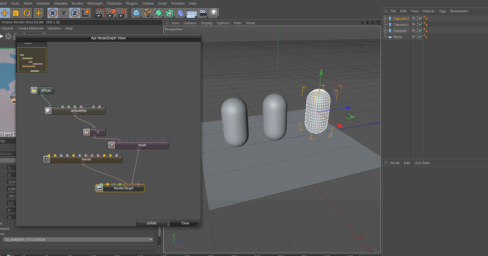

						i want to make more comprehensible the processing of export process. Until it's replaced with more clever algoritm, it's like that.ChrisVis wrote:Hi Mate,mate wrote:We have a scene which only needs 500mb VRAM but crashes with anything less than 22GB physical Memory.
Why does it need sommuch RAM, is this normal? also, it was a Pain to find the error, a better exception handling and/or better error logs would be much appreciated.
is the RAM usaged depending on the render resolution? As I experienced geometry data seems to need more VRAM or even RAM if final render is more than HD resolution. I rendered a 7000x5000 Image yesterday and it took o lot more time for the exporting process and also showed a higher VRAM load, at least in the little render progress bar overlay (down left corner of the image) in the picture manager renderer. Not sure about the RAM usage, didn`t observe that.
@aoktar: Is this the way octane handles the data? More final render resolution means more VRAM / RAM usage in terms of geometry? Or is it only related to texture data?
So it might be possible that a scene with 1000MB VRAM usage can be rendered in HD resolution on a 1.5GB graphic card but maybe not be renderable at a very high print resolution on the same card?
Please correct this if its wrong.![]()
Thanks for the tip with the objecttag mesh numbers, I asked me that question yesterday, why there are different numbers choosable. So thats quite handy to know![]()
Greetings,
ChrisVis
If we look two images, in first image, every geomtery is collected under a octane mesh. But in second scene, you'll see every capsule object assigned different geometries. Buffering of geometry is done seperated arrays and free after each proces. Because of this, peak memory usage will be lower than collecting all meshes to one geometry.
for other questions, this are internal parts of rendering. And done in Octane Render side. So this must be similar to Octane Standalone process. If there is some differents for handling memory, this can be a sdk problems or a different memory handling. But personally i did 6000x4000 renders on gtx590's. Scenes not so simple, some interiors.
