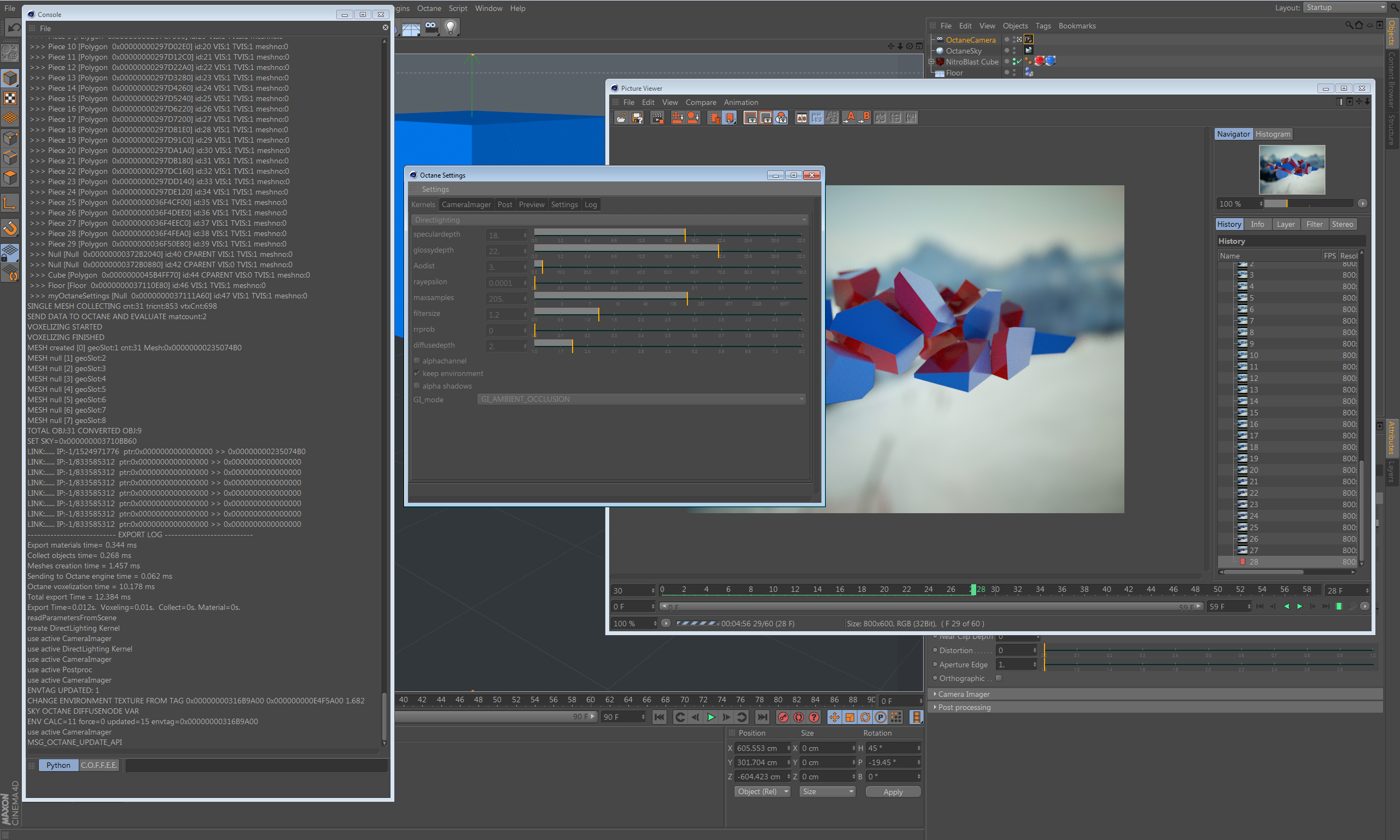

My problems with halting animations continues.
After 10 minutes the render was still stalled.
Here is a screenshot of a halted test animation attached.
I should mention that both of my two GPUs was set to render.
Win 7 x64 | 2 x GTX580 3GB | i7-2600K 3.4GHz | 16GB | Cinema 4D R14 | Nvidia 320.18
Posts: 16067
Location: Türkiye
DennisK4 wrote:My problems with halting animations continues.
can you send me your scene? I have detected when scene has no polygon a holding render problem.
