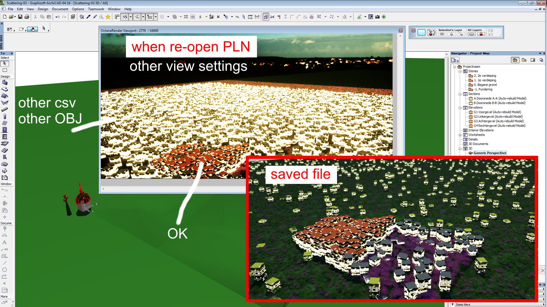

1) when saving the PLn file and re-open the file,
it did not open with the latest settings when saved;
got different csv, OBJ-proxy, but also other view settings (texture background instead of daylight).
Looks like it reloaded older settings, or mixed up some settings?

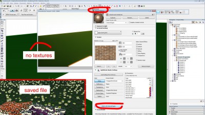

2) I encountered this in earlier versions too (but maybe I did not mention irt before.. I am not sure): sometimes the textures are missing.. as well in Archicad and therefor in the plugin. I can solve it by just open a material with texture and save it. It does not have to be the specific material, so it looks like it just has to reload the liobrary again?

Thanks Jeroen - I'll check these out in the next 24hrs. I've had the "did not save" before but (thought I had) fixed it. If you notice a particular sequence/workflow which is able to reproduce this issue every time, pls let me know.

I got a quick quit Archicad when pushing the play/pause render button a few times (too fast)
and when reopened the PLN I missed all the textures again. Could easily resolve by just open the material library and not even adjust a material, but just close library.
greetings, Jeroen

It is happening in the Archicad scene when opening the PLN (even before starting the plugin).
The standard Archicad materials from the AC library are not shown with textures.

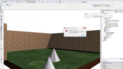

I started a completely new PLN to see if erors as in previous posts occur again.
After modelling a bit I started the plugin and this error occured:
I closed the plugin, re-opened it and no error appeared this time.

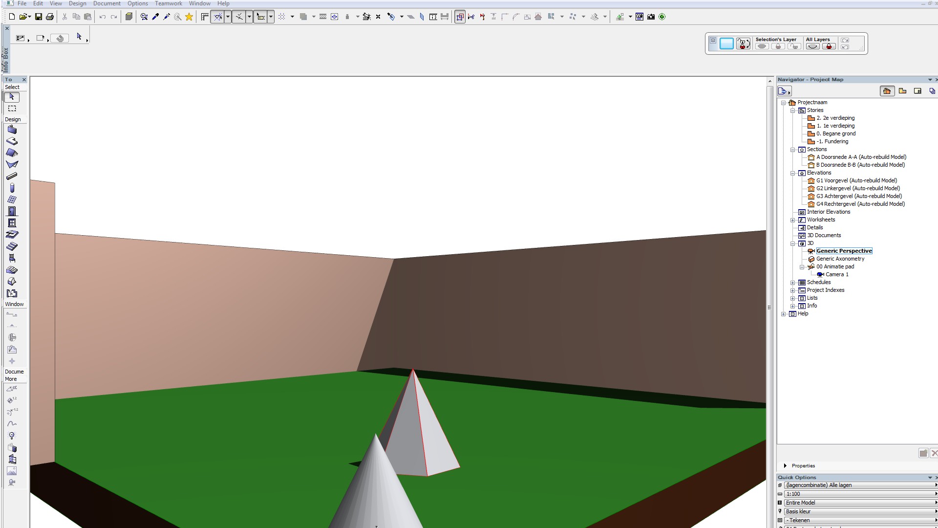

I saved the PLN, closed Archicad re-opened the PLN and the materials are without textures????
I opende the AC material library and closed it again.. the materials are OK with textures again.
I closed the PLn without having opened the plugin and it is without textures again!.
