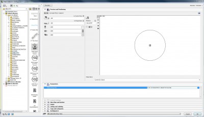

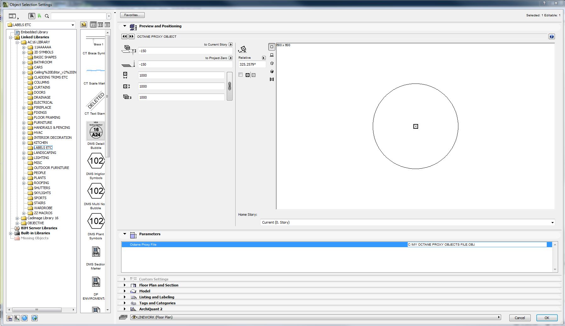

I have been playing around with the proxy objects, wow what a game changer for archicad users!!!
One annoying thing i have found is when you copy or alt click an archicad "placer" object it loses the octane proxy information, is there a way to code the proxy file name into an archicad object so that it always refers to that object ie have a specific field in the objects gdl code that you can use to pull thru the proxy file location?, I want to have number of placholder objects already set up with their proxy objects sitting on my template then just alt click and place the desired objects within the scene.
This would be a great enhancement to the plug-in
I have attached a very simple archicad placeholder object for you try out.
I would absolutely love to implement proxy's this way. There were some limitations in the ArchiCAD API which made attaching the obj file to the object tricky - so I left it out of the initial implementation, but I am sure it is possible with some more work. I will revisit this in the next week.
[EDIT: Additionally, the rotation of the ArchiCAD object could be added to the rotation of the OBJ proxy, which would be a further time-saver.]
